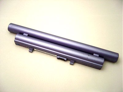

Once the screws have been removed, the case can be pulled apart. But be careful, the battery cells in the BP52 are connected to the circuit board via wires, rather than connected directly to the board. The following picture shows the inside of the battery pack. Note and pay close attention to the polarity of the battery cells; the battery cells are not all facing the same direction!
