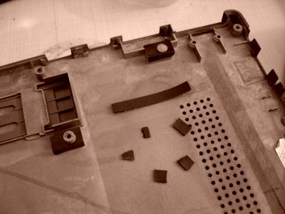

Almost ready to give up the idea, I noticed that there is a rubber strip on the rear chassis (see photo below), where the hard drive would sit. I assume that the rubber strip is for damping the hard drive. Now, if I remove that strip of rubber, it's quite likely that I can fit a 9.5mm drive in the tablet computer.
After a minute of pulling and tugging, the rubber strip finally came out. And a test fit of the chassis seems to indicate it will screw together without any gaps.

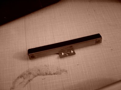

After doing the test fit, I started peeling off the rubber strip on the hard drive mounting bracket (see below). The hard drive mounting bracket is made for 8.5mm drive, but it works ok with a 9.5mm drive. After putting the case together, it seems to be a perfect fit.
