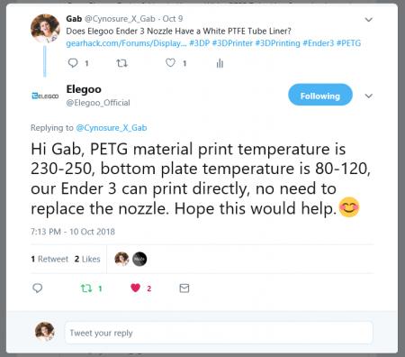

Elegoo responded to your message on Twitter:
"Hi Gab, PETG material print temperature is 230-250, bottom plate temperature is 80-120, our Ender 3 can print directly, no need to replace the nozzle. Hope this would help."

Thanks to @LetsPrint_3D for the following tweet:
"@Cynosure_X_Gab I was just notified of your tweet to @Elegoo_Official about PETG printing temps and PTFE lined hotends. Despite what they said, if the heatbreak does in fact have PTFE liner, do NOT exceed 245°C without an all metal hotend (most PETG does print fine around 240C)"
