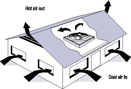

One amazing method to, not only cool the attic, but to suck in cool air into your house is to install a whole house fan (see diagram below). The whole house fan moves air from your living space into the attic, and out through the vent. This circulation also sucks cool air from the outside into your living space. It is really a simple and efficient technology. Although it is really not that hard to install a whole house fan, I am just not ready to put a big hole between the living area and the attic. For now, I will stick to cooling the attic.

For this project I bought three Lasko Weather-Shield 20" Box Fans with Thermostat. This fan has three speeds plus temperature control. The temperature control allows the fan to turn off when the attic is cool enough. But that is not sufficient, because when the air outside is hotter, there is no point to turning on the fan. Therefore, during the day, the fan should be off. So I got a few Intermatic TN111GC Lamp and Appliance Timers (same as the RadioShack 61-1068 Mini Lamp/Appliance Timer) to turn on the fan at dusk.
Two of these fans will go into the attic, facing out on the larger attic vents. The fans will blow hot air out, which will cause cooler air to be drawn into the attic. The third fan will go into the garage attic, to blow out the air from the front house vent.
