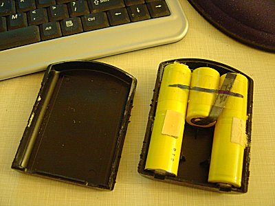

I have an Eureka cordless vacuum. It's Eureka 39150 rechargeable battery has died long time ago. Luckily it one that can be removed and plugged in. It's a 6v battery. But for some reason, I could not mentally predict what kind of cells makes up 6v. I've been thinking about 3.6 and 7.2 volts too much lately. I've forgotten that five 1.2v C-Cell NiCd makes up 6v.
That is, until I broke the battery case apart (see photo below). The plastic case on the left is the backing, where you'll find the specification for the Eureka 39150 battery. There are five C-sized cells wired in series.
Searching for Eureka 39150 yields no results. But it does point to the Eureka 60776 battery, which looks identical. So why the different model number? Could it be that the Eureka 60776 contains NiMh battery cells rather than NiCd battery cells?
