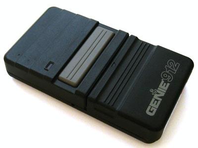

We bought a new home recently. It's got two garage doors. The smaller garage door has an opener that uses the Genie 912 remote control. It's an large ugly box that's reminiscent of something made in the 1980's. Is there another smaller, more modern remote control that would work with this opener?

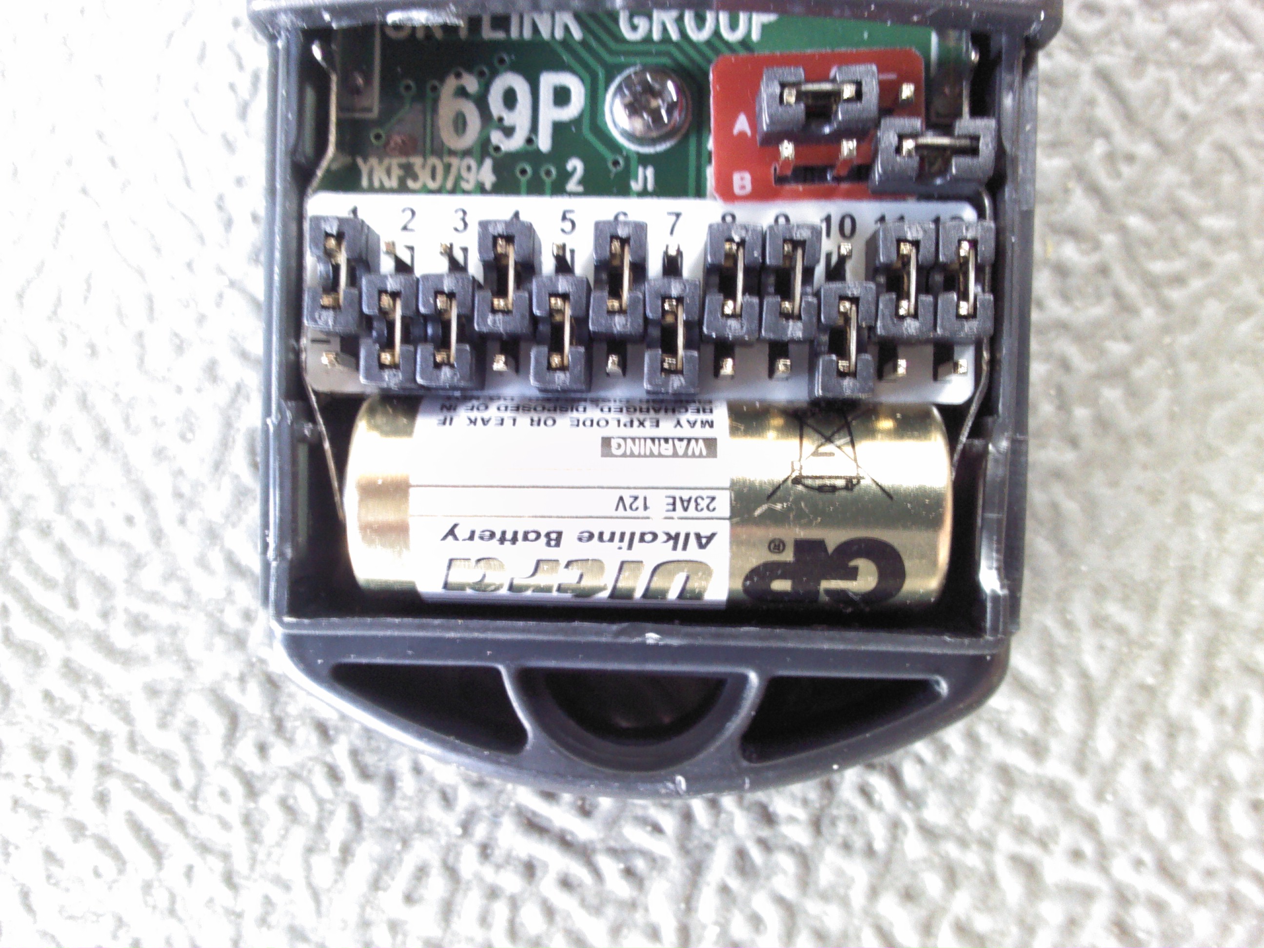

Found a more elegant remote control to replace the Genie 912. It is the Skylink 69P Universal Garage Door Remote Control. Got it on Amazon. The photo attached shows the DIP configuration to replace the Genie 912 remote.
Sat, 23 Jun 2012 00:32:05 +0400
The frequency switch on the Skylink 69P has to be set to 'A' for Genie garage door openers.
