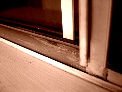

That's where the lumber comes in handy. A simple wooden pole cut to length serves as a window lock (see photo below). It's no more than a few bucks at the local hardware store. And if you buy one long enough, you can use it for multiple windows. Just make sure you no one could reach in from the outside to pull out the pole.

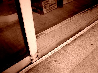

A long strip of lumber is could serve as a patio door lock (see photo below). The wider lumber provides a good stop for the heavy patio door. They are also very inexpensive at your local hardware store. Find one as straight as possible, without warping. And buy the harder wood.
Although I've used these two techniques during the summer months, there is no guarantee that they will work for you. They obviously don't work for windows that move up and down. If you can think of ways to circumvent these security measures, we'd love to hear them.
