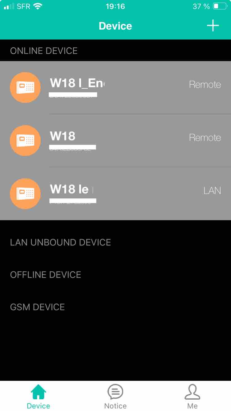

hello and happy new year 2024
after using my iphone to install and check the correct functioning of a W18 alarm at a friend's house
I would like to remove it from my list of online devices and only keep my own devices
THANK YOU
jk
Wed, 10 Jan 2024 01:43:21 -0800
