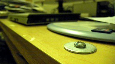

The following is a photo of the top bolt and a very large washer. I used a large washer on top because the desk is made out of particle board. The large washer distributes the pressure over the surface and prevents the particle board from damage.
Also, because it's particle board, I ran the bolt through the surface. It took away part of the flat surface, but it will not wear down the particle board over time. If it's not done this way, the desk probably won't last very long.

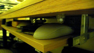

On the bottom, I attach an oak board strip. Oak board is very hard and strong. And you'll hear oak desks last a life time. The problem with oak desks is that they are extremely heavy. By using the a strip of oak board, you get the best of both world.
The bolt is a bit long. Rather than cutting the bolt with a hack saw. I used multiple washers and nut to make the bolt end flush. Most people will likely not perform this step. But I have little kids running around and I don't want the bolt end to cause forehead cuts.
