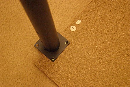

Mon, 15 Aug 2005 14:25:00 -0700
Upon arriving home with the desk, I realized that I made a slight miscalculation. Unlike the Legacy Glass L-Desk, where the corner panel is fastened onto the side of the two tabletops, the corner panel on the Z-Line Gemini "L" Computer Desk shares the legs with the two desks. Therefore, if the corner panel isn't used, the legs will stick halfway out from the desk as shown in the picture below.

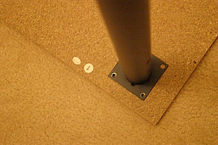

Mon, 15 Aug 2005 17:26:38 -0700
On one side, the desk has four screw fasteners for the leg.

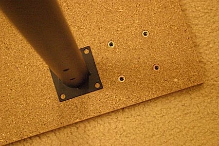

Mon, 15 Aug 2005 23:50:51 -0700
I wished the designers of this desk would have though of adding two more screw fasteners on the corner plate side so that the desk can be configured as two individual desks or one L-desk at will. With that thought, I realized that I could do the reconfiguration myself. I could simply move the leg in, bolting to the two holes that were meant for the corner plate (see picture below). Then all I have to do is drill two more holes and add two more screws to fasten the leg.
Mon, 15 Aug 2005 23:51:37 -0700

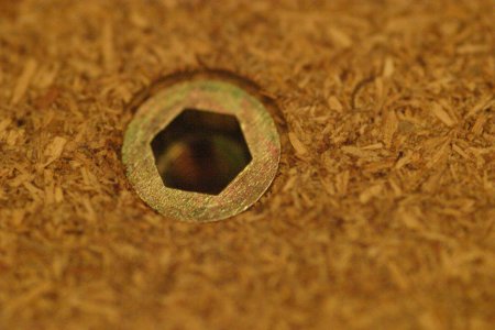

But I didn't do that, because the tabletop is a particleboard. To fasten to a particleboard, the designer used screw stubs (the lack of a better term) as shown in the picture below. If I screw directly into the particleboard, the board is likely to flake over time and the screw would pull right out. Two screws are currently holding the leg to the tabletop. However, I found a page on the Equality Screw Company that explains the difference between fasteners. There are a couple of screws for particleboards that I am willing to try. It seems particleboard screws need to have sharp and wide-space threads. And they can't be too long for this desk�about 1/2". I found two of these screws in my arsenal of screws. So I'll have to buy some more.

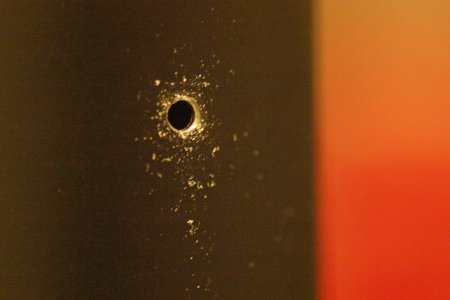

By moving the leg in, I had also shortened the distance between the legs on both side of the desk. This desk has bracing between all of the legs. And by shortening the distance, the back brace wouldn't fit. So I decided to drill new holes and fasten the brace to the legs myself. I started with a 7/64" drill bit and made a pilot hole in the leg (see picture below). Then I used an 11/64" drill bit for the final hole. I made the same holes on the brace.

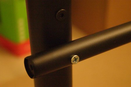

Wed, 17 Aug 2005 10:59:21 -0700
It was late at night when I put the desk together, so I didn't have Home Depot and Lowe's vast resource. Therefore I used #10 x 2" wood screws to fasten the brace to the legs (see picture below); entirely inappropriate. But at least the desk is holding together. At the next opportunity, I will have to stop by the home improvement store and get some machine screws and bolts.
