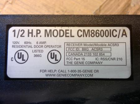

The photo below shows the full model number of this 1/2 HP garage door opener... CM8600IC/A

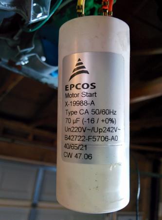

After calling Genie technical support, the tech recommended changing the capacitor. Apparently, capacity wearing out and failing over time is a reoccurring problem for all Genie screw drive garage door openers.
EPCOS
Motor Start
X-19988-A
Type CA 50/60Hz
70uF (-16 / +0%)
Un220V~/Up242V~
B42722-F5706-A0
40/65/21
CW 47.06
Sun, 15 Nov 2015 09:44:16 +0300
I happened to have a brand new 19988-A capacitor for the other, older model, Genie garage door opener that I was trying to fix. It's dark brownish in color rather than white. But the spec looks about the same. Following is the label for the 19988-A:
NGM ASSEMBLED IN MEXICO
61A23220060RNGN
70MFD 220VAC
-40/065/21 60Hz
LOT 61146178 21/03/2012 10:31
19988-a
I decided to try this capacitor with the Genie 8600 Garage Door Opener. It worked! The garage door moved up and down with no problems whatsoever.
