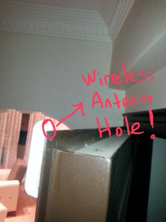

2- Magnetic door sensor mounted iron door but couldn't signal to main unit only 2 meters..
My solution like this (don't cover antenna hole )
