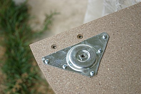

Originally, I was going to buy a long clothes-hanging rod (the people at home improvement stores call it a dole, but it's basically a long wooden pole), cut them into three legs, and mount them to the corner panel. Instead, Home Depot sells pre-made table legs and brackets. My wife liked them, so that's what we went with. A heavy-duty bracket costs about 3 bucks, while a carved wooden leg costs about 8. So three brackets and three legs were a bit more than I wanted to pay for a DIY project.
The picture shown below is a heavy-duty bracket mounted to the panel with particleboard screws. The bracket included these screws and I drilled pilot holes for them. I put one of these brackets at each corner of the panel. I kept the bracket clear of the original screw studs, so that if I want to put the corner panel back on the L-desk, I can do it without removing the bracket.

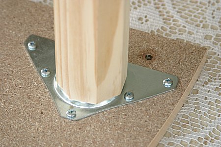

The carved wooden leg that Home Depot sells comes with a screw stud. So I didn't have to do any work at all. I simple screwed a leg into each of the three brackets as shown in the picture below.
