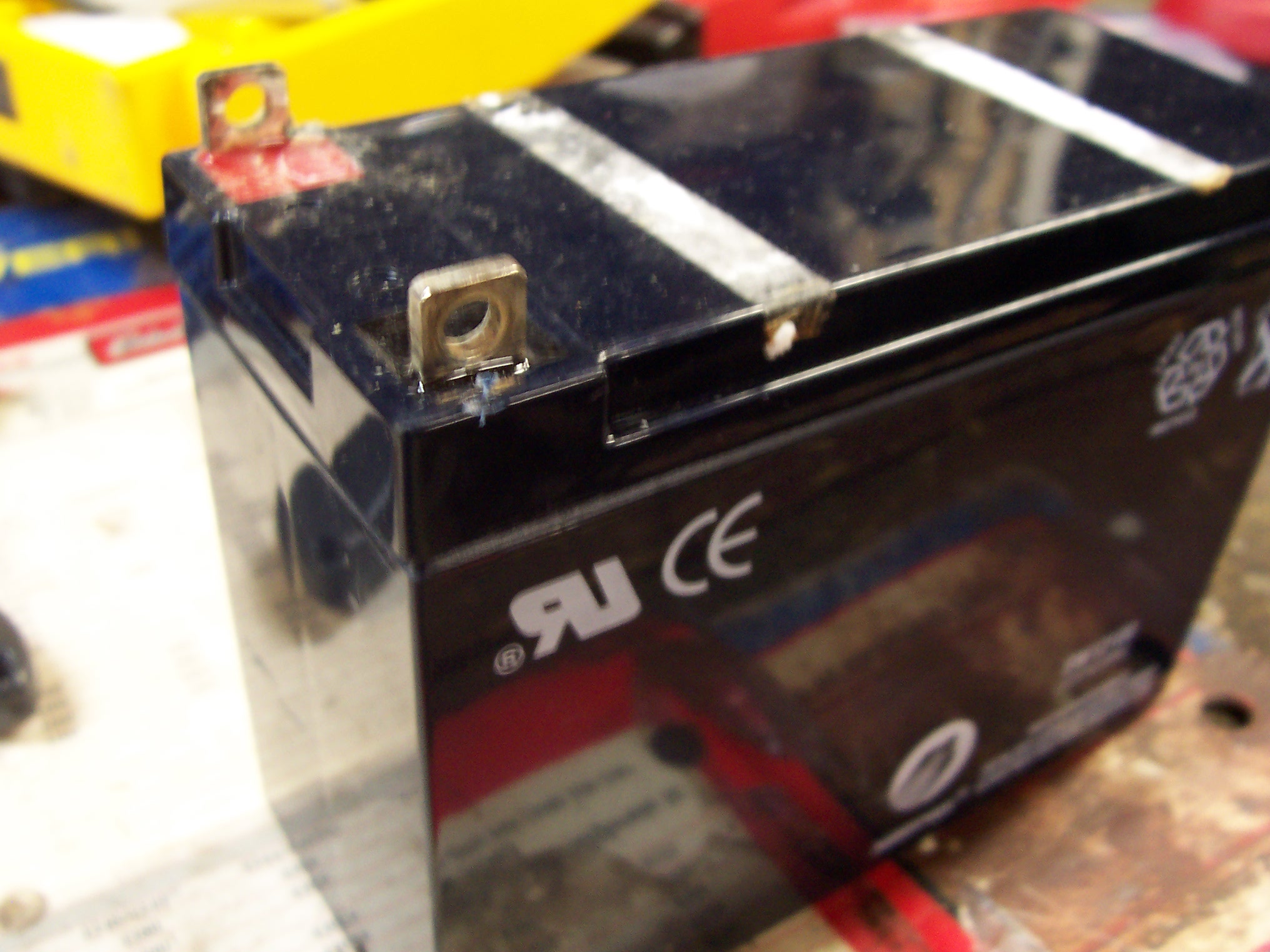

I have a Coleman PMJ8960 Jumpstart System. It's a portable jump-start battery for your car. So far, I have never used it for my car. But it has a fluorescent work light that can last all night on its 10 amp hour battery. It has been my late hour working companion for years. Recently, this companion would not hold a charge. Maybe I should have let it drain completely. Or maybe the battery is just too old.
So I took it apart, hoping to replace the battery. The battery is a "Fuli FL12100", 12 volt, 10 amp hour battery. But I can't find this battery anywhere online! It's almost as if this battery doesn't exist.
So my favorite companion sits there on the garage floor, lifeless until I can find a way to revive him.

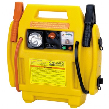

Hello, i have a 12V Jump Start w/Air Comp 17Amp, just like motst owners here, i lost the wall charger. i have a stand alone 6v/12v charger, so was thinking of coonecting the stand-alone direct yo the interbal battery to charge it. Has any one tried this option before?
Thanks,
HJ

I am looking for a battery for my Coleman Powermate jump box #PMJ8960-T. The battery was a Sunnyway #SW12100. 12Volt-10amphr. I have attached a copy of a picture of the battery. You will notice it has bolt on terminals and not spade like the currant models have. Can anone out there help me???
Frank Shockley

Okay, did a bunch of research, and found a source for a replacement battery, from a company based out of California! The name is Tempest Battery, and their website is www.batteryspec.com. The exact replacement battery is TR10-12C, and it has the T25 1/4" nut and bolt terminals. The rating is 12V 10Ah. The original battery inside is Fuli FL12100S (the S is the nut terminal version), or the Sunnyway SW12100 (it appears sunnyway has discontinued the nut terminal, as it is not listed on their web site). Others have stated the BB battery 1290 is a replacement, but that is NOT the full equivalent of the original, because the BB is rated at 12V 9Ah, so it is smaller in capacity, and so performance is probably worse than the original.
For those who have lost the charger, you can get a 12V 500mA charger, or you can charge the battery through the jumper cables with a 12V battery charger (set on "AGM" as the battery type, not wet or gel battery). The original battery is a sealed AGM type battery.
batteryspec.com has a host of other batteries as well, so you can type in your model number (like PMJ8960) in the search window, and they will come back with an equivalent. I don't work for the company, but just spent several hours trying to find a replacement battery, and thought this might help someone.
Glenn
Wed, 27 Jan 2016 22:18:38 +0300
Sorry, there was a typo: The Terminal type is "T5", 1/4" Nut and bolt terminal.
