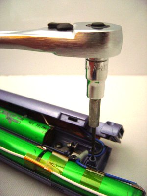

So here it is . . . a manual drill composed of:
  • a �� ratchet
  • a �� socket
  • a drill bit made for electronic screwdrivers

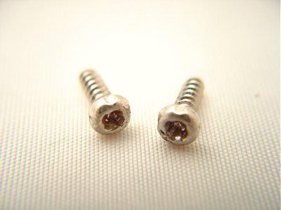

I put this together when I was rebuilding my PCGA-BP52 notebook battery pack. The battery pack had temper-proof screws that I managed to remove. I had to re-tap the screw holes for a set of bigger, non-temper-proof, screws. An electronic screwdriver might apply too much torque at the wrong time and crack the plastic thread. A manual drill that provides feedback to our sensitive fingertips is best in this case.
