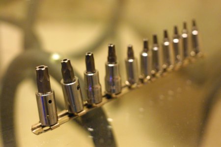

I ordered the "SK Hand Tool (SK 84231) 11 Pc. Tamper-Proof TORX Plus Bits Socket Set" through Amazon. It actually supplied by ToolTopia, an Amazon affiliate. After waiting patiently for a week, the bits finally arrived. I had the fingers crossed that the bits won't be a set of regular TORX bits. They weren't.
The tamper-proof TORX Plus bits came on a socket rail. I've always wondered why bits would be installed in sockets. But after some thought, I realized the bigger TORX bits won't fit a regular screw driver bit socket. If you know a better reason, please share it with us. Luckily I had a 1/4" drive socket adapter that I could use with my screw driver.

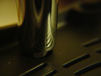

In a few minutes of having the new bits, I had taken the Seagate 80 GB External Hard Drive case apart. The case is quite well made, with a lot of metal heat sinks. I would have no hesitation of putting any new hard drive in such a case. The gray cover that looks like a metal cover turned out to be plastic.

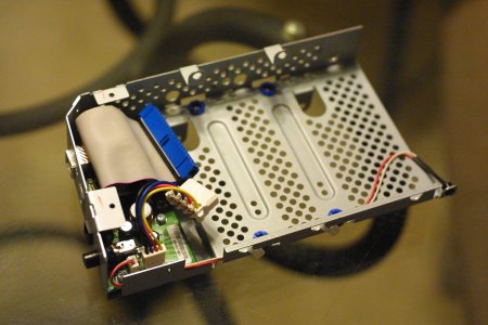

Since I had the external drive case apart, I figured I might as well test the case and see if it would accept other hard drives. A brand new Seagate Barracuda 250 GB IDE hard drive happened to show up at my door on the same day. It was a replacement for a warranted drive (see my "Hard Disk Crash" article elsewhere on this site). Of course, this test would kill two birds with one stone, because it would also test whether this replacement drive works or not.
I removed the internal hard drive and the internal metal bracket from the external case. The internal hard drive was securely with various mounting screws and rubber dampers. After removing the drive from the metal bracket, the bracket is bare for a new drive (see picture below).
Installing the new hard disk was rather easy. The case readily accepted the new 2.5" hard disk. And the computer recognized the hard disk immediately. I went through the process of partitioning the drive and formatting it. The USB external case and the new internal hard drive worked flawlessly.

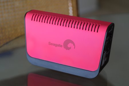

I finally painted the case fluorescent pink, a color picked out by my wife. After installing the original drive and bracket back into the case, I put it back together. With the new tampering-proof TORX Plus bits in my tool chest, I am no longer so anxious to replace the screws with standard Phillips screws. I screwed the original screws back. But I should find some time to source the regular screws for convenience.
The new color is amazing. It made the original boring gray computer peripheral into a flamboyant, eye-catching gadget. It looks much better even behind my--a man's--eyes.

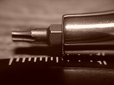

I've attached the photo below. My external hard drive is ST380203U2-RK. I don't know if your enclosure is the same one as the one I painted pink above.
I want to shoot a photo with the ruler beside the bit. But I can't right now, because the baby is sleeping in my left arm ... so maybe later.
Wed, 15 Aug 2007 05:40:41 +0000
Ok, baby is quietly asleep . . . attach is the photo showing the measurement of the T20 bit in inches.

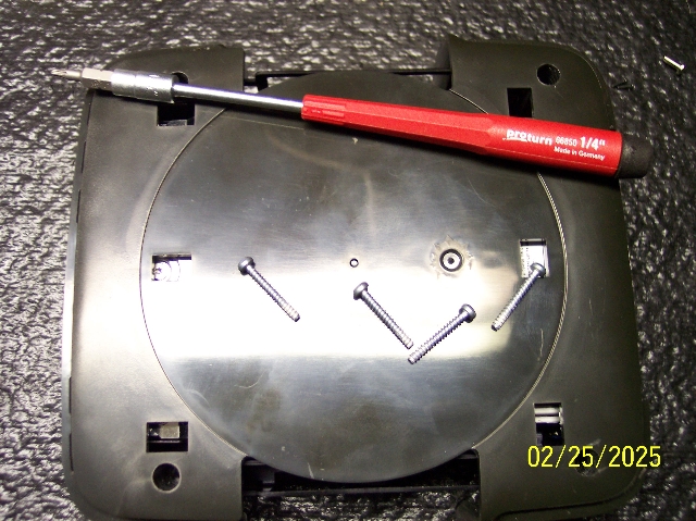

Problem solved. - OK - out of frustration here's how I decided to delicately resolve this problem. Having ordered the 6,7,8,10 and 20 Torx Plus Tamper Resistant bits from WiHa and searching and waiting weeks before that for the right tools to crack the Seagate case - I then decided I needed to make the case fit the tool.
My case (320GB external) had a long, narrow recess - and to boot it was slightly under 1/4" round. Nothing wrong with the case - but the hard drive was shot. And the bits from Wiha did not fit the hole circumference. IO also had doubts about the depth. So - I decided I would drill out the hole another 1/16th. Using a nice sharp 5/16 bit on slow speed - I carefully drilled out the hole - voila - as you can see in picture - you can't even tell it was drilled out. (The outer shell covers these holes anyway) Then I needed T-10 Security Plus bit. Dropped into the hole - there was JUST enough reveal on the bit to get a bite with the holder and with the hole drilled out - enough room to spin it. Problem solved! To keep the bit from recessing to0 far into the holder - I wadded up some solder wire and out it inside the holder.

I read this board and saw the suggestion about filing down a six-point tamper-proof torx bit -- I can tell you it worked a treat! It took a little while to file down the points enough, but with a bit of patience the screws came out easily, and best of all, the set only cost me �2 (that's less than $5). Just a tip - get the cheapest set. They won't last as long, but the cheaper ones are made of softer metal, and are therefore easier to file. I'm going to replace the screws with more normal ones, but for the moment I've used two of the screws found on the inside of the case to secure the cover in place.
Thanks a lot, Chieh and Tony!
P.S. My drive looks exactly like the one pictured, but the T20 was too small - I filed down and used the T25 in the end.

Check out Harbor Freight. They have various size sets for security bits for under $10. I ended up getting this one. http://www.harborfreight.com/cpi/ctaf/Displayitem.taf?itemnu . . .
They have a smaller 33 piece set for $5 and the same set with 1" long bits for a similar price. I also had to drill out the holse on my seagate just a little bit to ensure I could get the driver to even reach the screw. After that, it all came out like a dream.

I had the same drive as pictured in the first post, and instead of buying any expensive bits I'm probably never going to use again I just grabbed a drill with a bit that was smaller than the t20 and drilled out the center of all 4 safety Torque screws.
Since the drill bit rounded out a bit of the points besides the center i easily was able to unscrew them with a regular torqx bit.
After I removed the cover i noticed the hard drive is held in place with the exact same size screw, only Phillips, so I only used two to hold the drive in place and used the other two to re-secure the cover.

I used the "two precision screwdriver" solution described by compubear. Once I got the knack I had all four screws unscrewed in 5 mins. So much for "anti-tamper".

I just found a set of the 5 sided TS bits for approximately $25 including shipping in the US. Link below:
http://www.zdmak.com/wbstore/main.asp?action=PROD&PROD=MK-40 . . .

Hey there. I was just trying to get my Seagate drive apart and stumbled across this site. Stupid Seagate.
Rather than spend $$$ on some stupid driver I'm never going to use again, I did what banchang did (at least I think). I used a small, flat precision driver to torque out the screw. You can't just "twist" the driver, you have to torque the driver and push around the outside of the screw. Imagine taking a spatula and running it around the side of a mixing bowl. Once I set the screw, I torque it, then turn the unit beneath to force out the screw.
I don't plan on reusing the screws, but I guess I could just take a dremel and cut a notch in the top to create a standard flathead screw.

Hi guys - I'm way behind your posts and hope veryone has sorted this problem now. I just found your posts cos I was having the same problem. Got into a sweat when you were talking about the price of specialist tools. So - my advice is get a cheapo watchmakers set for little money. Use the 2.4mm & 2.0mm flat heads together on each screw with the shafts crossing each other slightly - then twist the drivers counter-clockwise together. The screw should loosen off then twist it out with just one driver. Repeat with the other 3. Sorted!
By the way, the 4 philips-head screws holding the HD casing to the outer body are the same size thread as those nasty 5-pole tamper proof Torx screws. So bin the Torx screws and use just 2 philips on each mounting (or get some more from your hardware store).

ZDMAK: I bought from this guy... I bought a 5PT & 6PT security set $19.99 + $6 s/h
http://motors.shop.ebay.com/zdmak/m.html?_nkw=&_armrs=1&_fro . . .
Considering the warranty you may be able to save on these drives (especially if you scavenge them for IDE/PATA systems not a bad price.

The link to amazon to buy the 5 point star security key bit is not available for sale anymore.
Here is a new link to a set I am buying to get my Seagate external drive open.
Silverhill 5 Point Star Tamper Proof Bit Set, 10 Piece
Vito Damiano
Mon, 28 Feb 2011 16:05:21 +0000
I got this set for $3.99 on Amazon, and was able to open a Seagate HDD. Just posting here, because this is one of the spots where I was looking for guidance on the issue. Silverhill 5 Point Star Screwdrivers (2-Pack)
Good Luck!

I was faced with a bit too short and decided to carefully weld it onto another failed standard screw driver. Now I have a five point 6" long.

How did you get the T20 to work when the set you reference does't have the hole in the center for the nipple in the screws? I found a set of security torques at AutoZone today and even the T20 with the hole doesn't fit.
WIlliam
Sun, 10 Nov 2013 01:18:16 +0300
William,
I don't understand what you mean by "the set you reference does't have the hole in the center for the nipple in the screws". The "SK Hand Tool (SK 84231) 11 Pc. Tamper-Proof TORX Plus Bits Socket Set" I bought off Amazon a long time ago (see link and photo in the earlier part of this thread) does have the hold in the center.
You have to be sure that you have the Security (Temper-Proof) Torx Plus, which has the hole, not the standard Torx bits. Both standard and the Security (Temper-Proof) Torx Plus uses the same size specification (e.g. T20). If you have Security (Temper-Proof) Torx Plus bits, but the T20 doesn't fit, then I am guessing Seagate has change the screw head on their drives. Either it is now a different size or it is no longer Security (Temper-Proof) Torx Plus. Show us a photo of the screw head.
