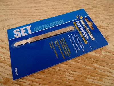

While at Lowes, I spotted another option--a tile-cutting saber saw blade (see photo below). This $5 jigsaw blade was suppose to be able to cut stone and ceramic tiles. I decided to give it a try.
And it worked, sort of. Mounting it onto my jigsaw was easy enough. But the next question was whether to set my variable-speed jigsaw to fast or slow. The packaging did not specify a speed. After cutting the notch I needed, the answer is to set it to medium. And it took a very long time to make a one inch cut.
So it's no replacement for a wet cutter. But if you have a small cutting job and have enough patience, the tile-cutting blade can give you a piece of mind.
