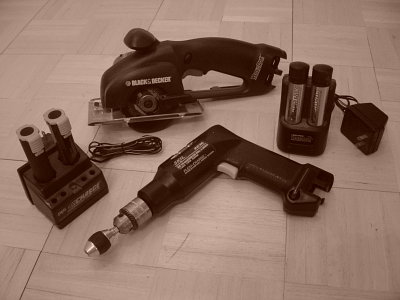

I have several cordless power tools. They all use proprietary 7.2 volt batteries. The photo below shows two of my cordless power tools: a Black & Decker saw and a Skil drill. Each of these power tools comes with two 3.6v batteries (installs in series to make 7.2 volts). Although the batteries are exactly the same, they are built into physically different packages. The Black & Decker's batteries are called VersaPak, while the Skil's batteries are called Flexi-Charge. Over the years, these batteries dies due to age, or due to lack of use. You can still find replacements online (see "Related Links" below), but they are extremely difficult to find in local stores.
One of the reason for their extinction is that the power tool manufacturers want you to not only buy more batteries, but also want you to upgrade your tools. So they keep coming up with new battery form factors, rather than selling you the same old stuff. For example, at this writing, rather than producing more VersaPak tools and batteries, Black & Decker is marketing a new line of tools and batteries called the VPX system. There is nothing new in the VPX system, except that the batteries are Lithium Ion, rather than NiCd or NiMh. The VPX battery is still 7.2 volts.

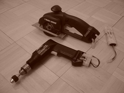

After picking up several Tamiya battery connectors and battery packs (they are now available in both NiCd and NiMh types), I took my power tools apart. Once they are apart, I soldered the Tamiya battery connectors onto the existing proprietary battery connectors. Next, I shaved off parts of the inside so that the standard 7.2v RC battery can slide in, but not loose enough to slide out by itself. Now, all my power tools uses the standard 7.2v RC batteries (see photo below).

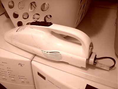

I recently converted a old Dirt Devil portable vacuum to use the 7.2v RC battery pack as shown in the photo below. This Dirt Devil portable vacuum used a 3.6v battery that has long died. After taking the vacuum apart, I saw that there is only a simple circuitry from the battery to the motor inside the casing. The motor was a basic analog magnetic motor, so I suspected that with more battery voltage, the motor will just spin faster; a more powerful vacuum. So I wired up the RC battery connector to it. The vacuum worked beautifully after that!

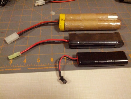

I also recently found the smaller airsoft batteries could fit nicely in electric tools. Check out the size differences below.
