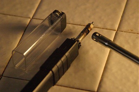

I have a Weller Portasol cordless soldering iron. This cordless soldering iron runs off butane gas, which is easily available at the local Home Depot. The soldering iron is quite convenient because it allows me to perform soldering jobs away from my workbench.
To start the soldering iron, you have to open the butane valve, then use the spark starter that is built into the cap to light up the butane burner. Although it is relative easy to generate spark from the cap, I have only been able to start the soldering iron once with it. Recently, I couldn't get the soldering iron to start at all despite wearing out my thumb with the "fire starter".
Everyone nowadays have lighter at home. No one uses matches anymore. And today, they have these ultra-safe lighters for starting BBQ's and stuff. So, it occurred to me that it would be really easy to start the butane soldering iron with a lighter (see attached picture). I happen to have one in the kitchen drawer. I pulled it out. The lighter started the cordless soldering iron instantly. I will never spend half-an-hour trying to light the cordless soldering iron with the spark generator again!

I just recently found mine when I moved my big tool box. I guess it had fallen down behind the tool box somehow some ten years ago. I thought someone took it, lol.
I was amazed when it lit right up after sitting unused for ten years. How is that even possible?
The built-in spark emitter deal is kind of awkward to use because you have to aim it just right so the sparks go into the ignition chamber but with a little practice it works okay.
