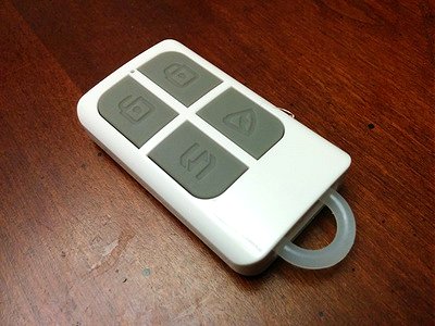

The control has four buttons (see photo below). The unlock button disarms the system. The lock button arms the system. The 'S' button arms the "stay" alarm. The bell button is the panic button that triggers the alarm immediately.
There is a LED at the top of the remote to indicate that you have pressed a button.

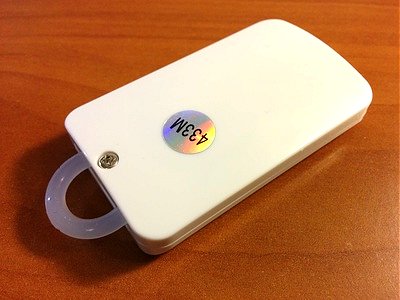

There is a small screw on the back of the remote control (see photo below). To get to the battery inside the remote, remove this screw. The remote case is snapped together. Use your fingernail or a small flat-head screwdriver to pry the shells apart.

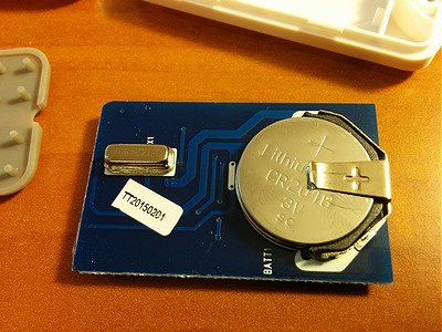

You'll find a stack of two 3-volt CR2016 lithium button cell batteries on the back of the remote control circuit board (see photo below). This button cell is relatively common and can be found at your local drug store. You can also order them online on Amazon (see "Related Links" below).

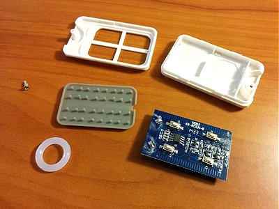

Parts include a small precision screw, the remote shells, rubber button pad, rubber o-ring, and the circuit board (see photo below).

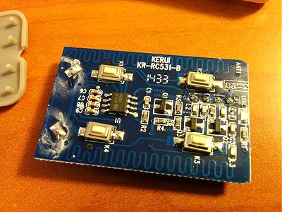

The following photo shows the close-up of the circuit board with the electronic switches.
