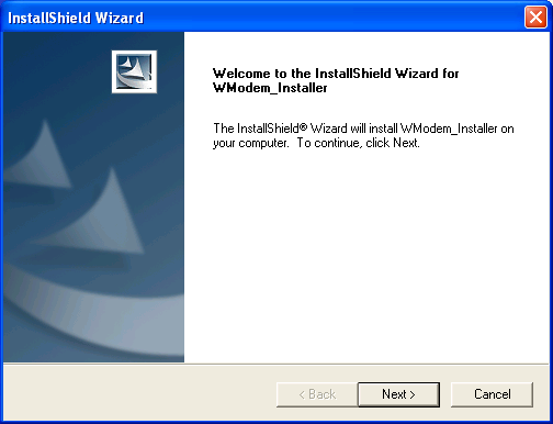

Install the Software

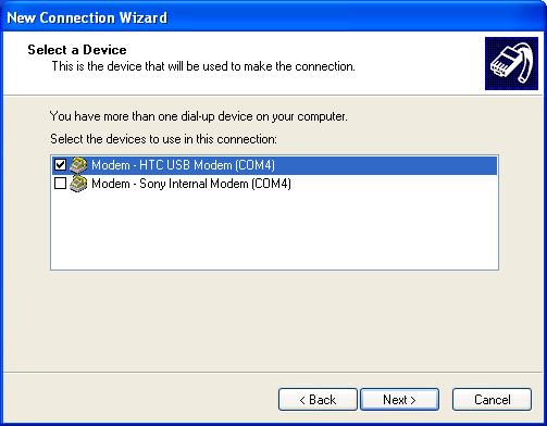

In the "Select a Device" dialog, check the "Modem - HTC USB Modem". Uncheck all other modem devices that may also show up in the list (see screen shot below). Ignore the "(COM4)" that showed up on my computer. It could be a different COM port on your computer. Click on the "Next >" button to continue.

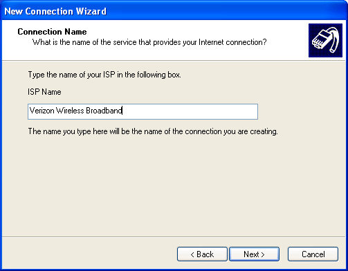

In the "Connection Name" dialog box, type in any connection name that you are comfortable with. I use "Verizon Wireless Broadband" to indicate that this is a connection through the Verizon Wireless EV-DO service. Click on the "Next >" button to continue.

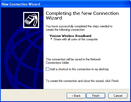

Now you are all done. In the final dialog box, you have the option to "Add a shortcut to this connection to my desktop" (see screen shot below). When you do, you will be able to easily access the network connection conveniently. Click on "Finish" to complete your dial-up set up.

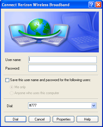

To connect your cellphone and your computer to the Internet, open up the "Network Connections" from "Control Panel" again. Double click on the new network connection you have made in previous steps. If you have already created a short-cut for it, you can skip the "Control Panel" step and double-click that directly. The following dialog will pop-up on your screen.
Do not fill in the dialog with any additional information. Simply click on the "Dial" button and you will be connected to the Internet.

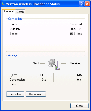

To disconnect your computer and your cellphone from the Internet, find the network connection symbol on your Windows Taskbar. The little icon on the right-hand side of the Taskbar (see screen shot below). It looks like two computer monitors. It will not have a red 'x' on it, meaning it's connected.
Once you find it, click on the network connection icon. It will bring up the status dialog as shown in the screen shot below. There is a "Disconnect" button on it. When you click on this button, you will disconnect the phone and the computer from the Internet.
