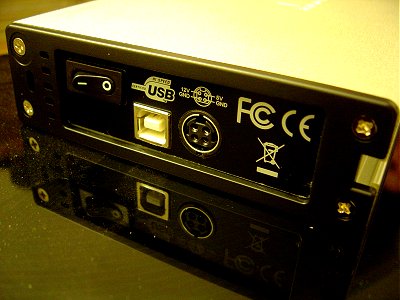

There are two reasons why I HAVE to buy this drive. 1) The power supply adapter is the same and I can move the drives between two computers without dragging the interface cables around; 2) I want to figure out reuse the Acomdata E5 HybridDrive enclosure with other hard drives. Plus, I needed another 500 GB drive to satisfy my Photo Storage Solution.

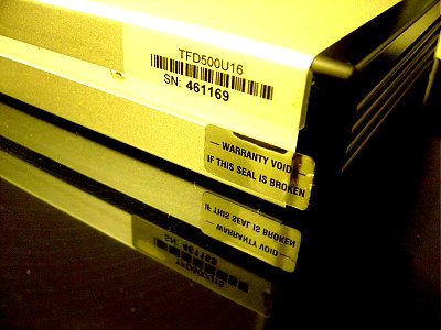

When I first got this drive, I had thought that maybe I was wrong about the AcomData E5 HybridDrive being an aluminum enclosure. After all, the name of this Fantom drive has the word Titanium in it. But apparently Titanium is just a marketing name and the product isn't made out of titanium. The Fantom drive card board box identified the drive enclosure as "attractive, rugged aluminum enclosure".

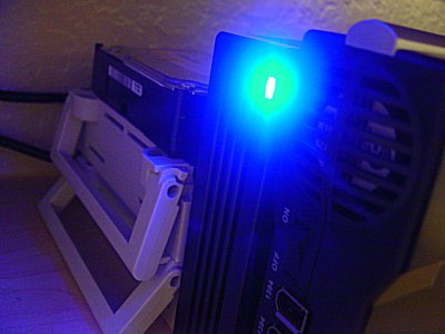

After opening the package, I pulled out the two power supply and did a comparison. They are indeed the same in power specification. The only difference is that the AcomData E5 HybridDrive uses a ground three-prong power plug while the Fantom Titanium drive uses a two-prong non-polarized plug. I tried the AcomData power supply on the Fantom drive and it worked just fine. Like the AcomData drive, a bright blue LED on the front of the drive indicates that the drive is on. Windows XP found mass storage drive and installed the driver automatically.

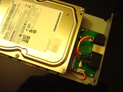

Inside the enclosure is a Samsung HD501LG 500 GB, 7200 RPM, 16 MB cache hard drive. It's connected to a much simpler SATA to USB converter board than the one found in the Acomdata E5 HybridDrive enclosure.
When I turned the internal bracket over to remove the Samsung hard drive, I noticed that Fantom only used three hard drive screws to mount the drive. I don't know if it was an oversight during manufacturing or if they purposely used three screws rather than four. Makes me wonder about their manufacturing process.
