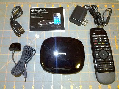

The Logitech Harmony Smart Control box actually indicates what's included:
  • Harmony Hub
  • Remote control (with battery)
  • IR mini blaster
  • USB cable
  • AC adapter
  • User documentation
The Logitech Harmony Smart Control is a really mysterious device. Even though it provides a list of included items, it's unclear what many of these items are for. The remote control and AC adapter is obvious, but what is a Harmony Hub?

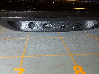

The Harmony Hub is a strange little device. It's a mystery what it actually does. The bottom of the device actually shows a WiFi MAC address. The reveals its intention a little. The back side of the device has four connectivity ports (see photo below):
  • Pair/Reset Button
  • microUSB
  • Audio port labeled as "1".
  • Audio port labeled as "2".
Logitech just doesn't let up with its riddles. "1" and "2"!? Are you kidding me? It turns out they are ports for the IR transmitters. The Logitech Harmoy instruction indicates that you should plug the IR transmitter into port 1. Apparently, through the Internet gravevine, you can plug a second control transmitter into port 2.
The microUSB port is used with the enclosed AC adapter to power the device. You can also use the enclosed USB cable to connect the Harmony Hub to your computer to configure it via MyHarmony web site. You'll need to download and install the Microsoft Silverlight and the Harmony Browser Plug-In to configure the Harmony Hub with your computer.
The pair/reset button is dual purpose. When you press this button while the device is powered up, it is reset to factory defaults. The light will blink rapidly for a while. When it's done, the device is reset. You can press this button during configuration with your SmartPhone for Bluetooth pairing.
The Harmony Hub is the central facilitator for this universal remote control system. After you configure it, it stays out of the scene--you'll never need to touch it again.

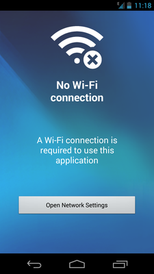

You can use the Harmony App to configure the Harmony Hub via Bluetooth. Once the Harmony Hub is configured, you will use the Harmony App to control your electronics and change Harmony Hub settings via WiFi. If your phone is off the WiFi network, Harmony app will disable the remote control function until you are back on the network (see screen shot below).

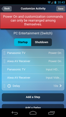

The Harmony app seems to impose some artificial limitations on activity programming. For example, my Panasonic plasma TV has an initialization time of about 10 seconds on start up. That means while it's turning on, it won't accept any remote control commands. That means the Harmony app can't switch inputs during that ten seconds.
The Harmony app does have a set delay command for activities. But for some reason, the Harmony app engineers decided it's a bad idea to let you move the delay between the TV turn on and input switch (see screen shot below). Personally, I think that's really short-sighted.

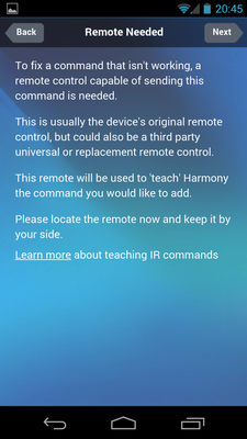

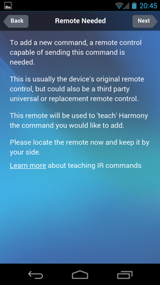

The Harmony app allows you to fix remote control commands. But it requires you to have to original remote to fix a particular command (see screen shot below). Sadly, one reason I purchased the Logitech Harmony Smart Control is because I wanted to replace a remote control I no longer have. So I can't fix the command, because I don't have the original remote. And really, all I wanted to do is to rename a command, which Harmony doesn't allow you to.

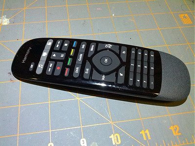

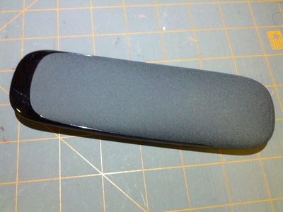

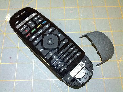

The Logitech Harmony Smart Control includes a simple universal remote control (see photo below). Although the simple remote looks unforgettable on the box, it's actually a remarkable device when you hold it in your hand. It's not big and clunky like other generic universal remote controls. It's thin, but has a hefty weight to it. There are quite a number of button on it. And each button provide a clear tactile feedback.
The battery is located at the bottom of the remote (see photo below). There is a hidden panel that can be removed, which also reveals the serial number and the part number (815-000100). It uses a CR2032 button cell battery.
Unlike other generic universal remote controls on the market, the Logitech Harmony remote control is activity oriented. That means the buttons on the remote works with all of the electronic device that is associated with the activity.
For example, my "Watch TV" activity involves the television and the Verizon FiOS set-top box (STB). After I press the "Watch TV" button on the remote control, the Harmony Hub turns on both devices. Now all of the buttons on the remote control works with the TV and STB.

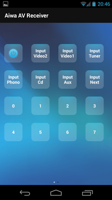

Will the Logitech Harmony remote support all of the functions on the original remote?

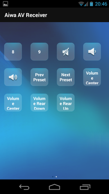

The basic answer to this question is "yes". The Aiwa AV-D30U remote in the Harmony App supported all of the functions on the original remote. Except the buttons aren't always labeled intuitively. For example, the DSP and GEQ functions are mapped to numeric buttons '1' and '2', respectively. Screen shots below shows the Aiwan AV-D30U remote in Harmony.
What if the original remote has buttons that is not on the Logitech Harmony remote?
You can assign any command to any Logitech Harmony button, as long as you have the original remote for programming. However, if you don't have the original remote, then you can only use the pre-programmed ones available from MyHarmony.
Can the Logitech Harmony remote buttons be remapped individually?
You can remap the buttons on the Logitech Harmony remote control. But individual component remote controls in the Harmony App cannot be remapped, renamed, or changed without the original manufacturer remote.
