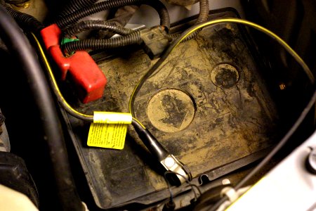

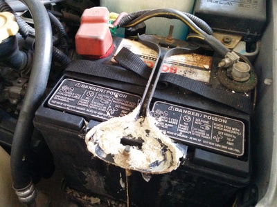

This third benefit is really the driving force of using these batteries in everyday driving. One of our friends left his car battery in the trunk of his car. It tipped, spilled onto the trunk carpet and a rag. The next day he found the remaining of what we guessed was a rag. It completely decomposed due to the battery acid. The following photo shows corrosion on the battery mount on my own car. I had to throw that mount away, because it could not be dissembled.

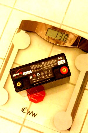

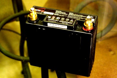

When we first started looking for light-weight batteries for our cars, we found the Hawker Genesis G16EP battery. It costed about $50 bucks, but has since then drastically increased in price. It is only 13.8 pounds; About a third of the weight of a regular car battery.

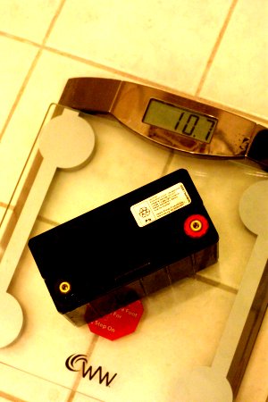

Later, we found a surplus of Hawker Genesis G13EP battery. We were able to pay $25 for each battery. The G13EP is slightly smaller than the G16EP and weighs only 10.7 pounds. We were thrilled with this battery.

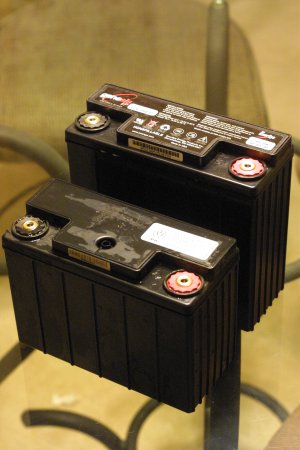

Source for this battery is in the "Related Links" section below. The following photo shows the size difference between the Hawker Genesis G13EP and G16EP.

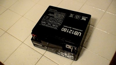

Universal Battery UB12180

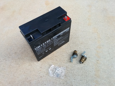

The Universal Battery UB12180 is a good candidate. This battery is about the same size as the Hawker Genesis G16EP. It weighs about the same as well. In fact, if you look at the specs, you'd say it is the same battery. The only difference is the terminal on top of the battery. It has bladed terminals used for wheel chairs and golf carts. At less than $50 a pop (including shipping), it's an excellent car battery replacement. In fact, over the years, price has actually dropped to $40, including shipping. Source for this battery are listed in the "Related Links" section below.
After using this battery for about a year or so in three different cars, we can say that it is practically the same as the Hawker Genesis G16EP. Only minor difference is that the Hawker Genesis battery can be mounted in any orientation, while the Universal Battery UB12180 has to sit up-right. More detail about this constrain in the mounting section below.

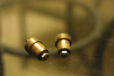

The Hawker Genesis batteries comes with M6 screw posts on top of the battery. So you simply need to get a pair of battery terminals that can screw onto the M6 posts. The part you will need is the following:
  • Odyssey 3217-0006 SAE Terminal Conversion Kit (Convert M6 Bolt Terminals to SAE 3/8" Receptacle Terminals).
You can source these parts in the "Related Links" below. You only need one set of these terminals for each car, because they can be re-used on each replacement battery.
With the part listed above, all you have to do is screw it into the battery terminals of the Hawker Genesis battery (see photo below) and you are good to go.

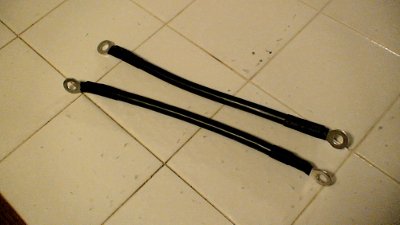

The UB12180 battery has bladed terminals on top. The vertical battery post on the Universal Battery UB12180 makes it difficult to convert to the SAE battery posts. The first bright idea we had was to use golf cart cables. For this idea to work, you'll need the following parts:
  • JERBOR 4-Gague Heavy Duty Golf Cart Battery Cables
You can source these parts in the "Related Links" below. You only need one set of these parts for each car, because they can be re-used on each replacement battery.
The UB12180 battery comes with screws and nuts. You can use them to fasten the golf cart cables to the battery. Then screw the "Odyssey 3217-0006" posts to the other end of the golf cart cable with two nuts..
The golf cart cables conversion is good if your existing battery cables don't reach. And it allows you to orient the battery the way you like. But after driving with it for a few days, it occurred to me that having moving parts (golf cables wiggling) may not be a good thing in the long term.

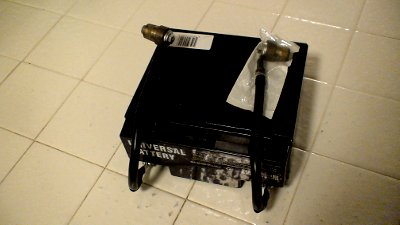

The next solutions was to use L-brackets. You'll need the following parts to implement this solution:
  • National Hardware N275-628 3/4 x 1/2-Inch Corner Bracket

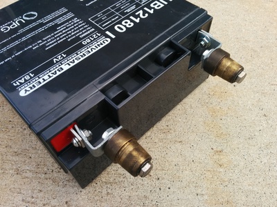

You can source the parts from links in the "Related Links" below. You only need one set of these terminals for each car, because they can be re-used on each replacement battery. Following photo shows the L-brackets screwed onto the terminals.
The UB12180 battery comes with screws and nuts. You can use them to fasten the L-brackets to the battery. The photo below shows the L-brackets mounted onto the battery.

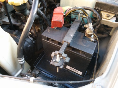

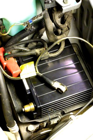

With the terminals mounted to the top of the UB12180 universal battery, you can mount it into your car much like any car battery. It's just one third the size of a regular car battery. The following photo shows the battery mounted upright in the car battery compartment.

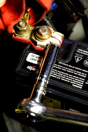

To lay the Hawker Genesis battery down, you have to screw the battery cables onto the battery post first, because they are too hard to work with when the battery is laying down.
Once the cable has been screwed onto the battery posts, you can lay the battery down as shown in the photo below.

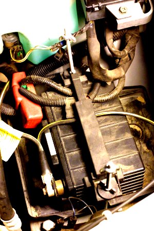

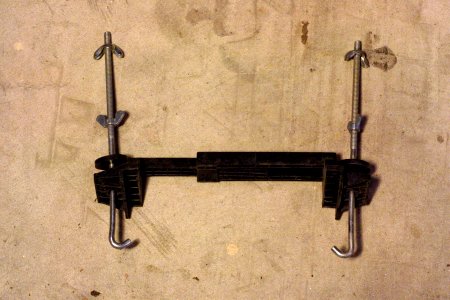

We have to get a special battery bracket (see photo below) that can mount a battery that low. The battery bracket that came with the car has threads that ends too early. Note that we added wing nuts to the top for additional cover.
Photo below shows the Hawker Genesis battery mounted in the vehicle.

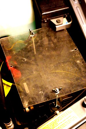

This battery is mounted into a 2001 Subaru Impreza 2.5 RS, where the engine hood had ventilation holes. We installed a sheet of plexiglass on top, using additional wing nuts, to route water away from the battery post (see photo below).
