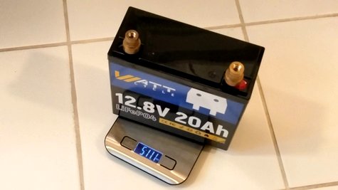

  • While the 12v 16A SLA battery weighs around 11 to 12 lbs, a 12V 20A LiFePO4 battery weighs around 6 lbs. That's half the weight of a SLA battery, providing further weight reduction in your race car.

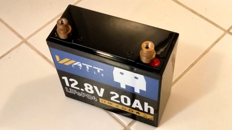

Wattcycle 12V 20Ah LiFePO4 Battery
In order to test our thought, we purchased a Wattcycle 12V 20Ah LiFePO4 battery during Amazon Black Friday sale. This battery is roughly the same size as the 12V 18Ah SLA battery we used in our 2001 Subaru Impreza 2.5 RS for the past 16 years. And it only weighs 5 lbs 11 oz. (see photo below), which is roughly half the weight of an equivalent SLA battery!

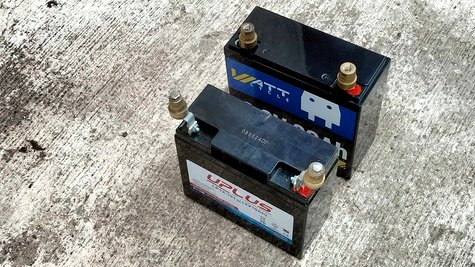

Placing the Wattcycle LiFePO4 battery behind the Uplus SLA battery in the photo below, we see that the LiFePO4 is roughly the same size as the SLA battery. It's taller by approximately an inch. But the terminal posts are actually about the same height, because the SLA is using angle brackets.
Both batteries are shorter than full size car batteries, so there is no problem fitting either batteries in the engine compartment.

The Wattcycle LiFePO4 batter comes with M6 screw posts on top of the battery. So you simply need to get a pair of battery terminals that can screw onto the M6 posts. The part you will need is the following:
  • Ampper M6 Thread Male Brass Battery Terminal Charging Posts
You can source these parts in the "Related Links" below. You only need one set of these terminals for each car, because they can be re-used on each replacement battery. With these parts, all you have to do is screw them into the battery terminals of the battery (see photo below) and you are good to go.
