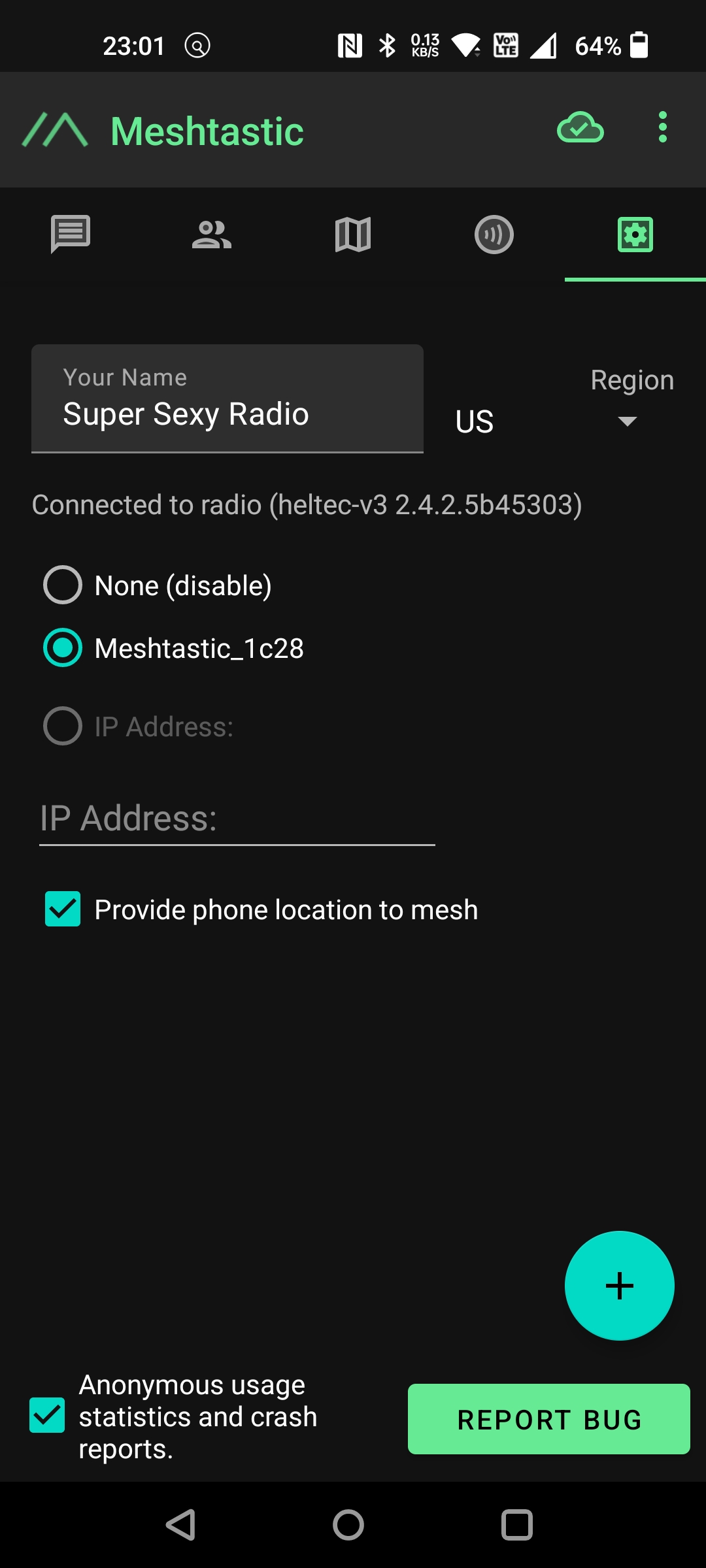

When you launch the Meshtastic app for the first time, you will be presented with the following user and region screen. The user name and region will be unset.

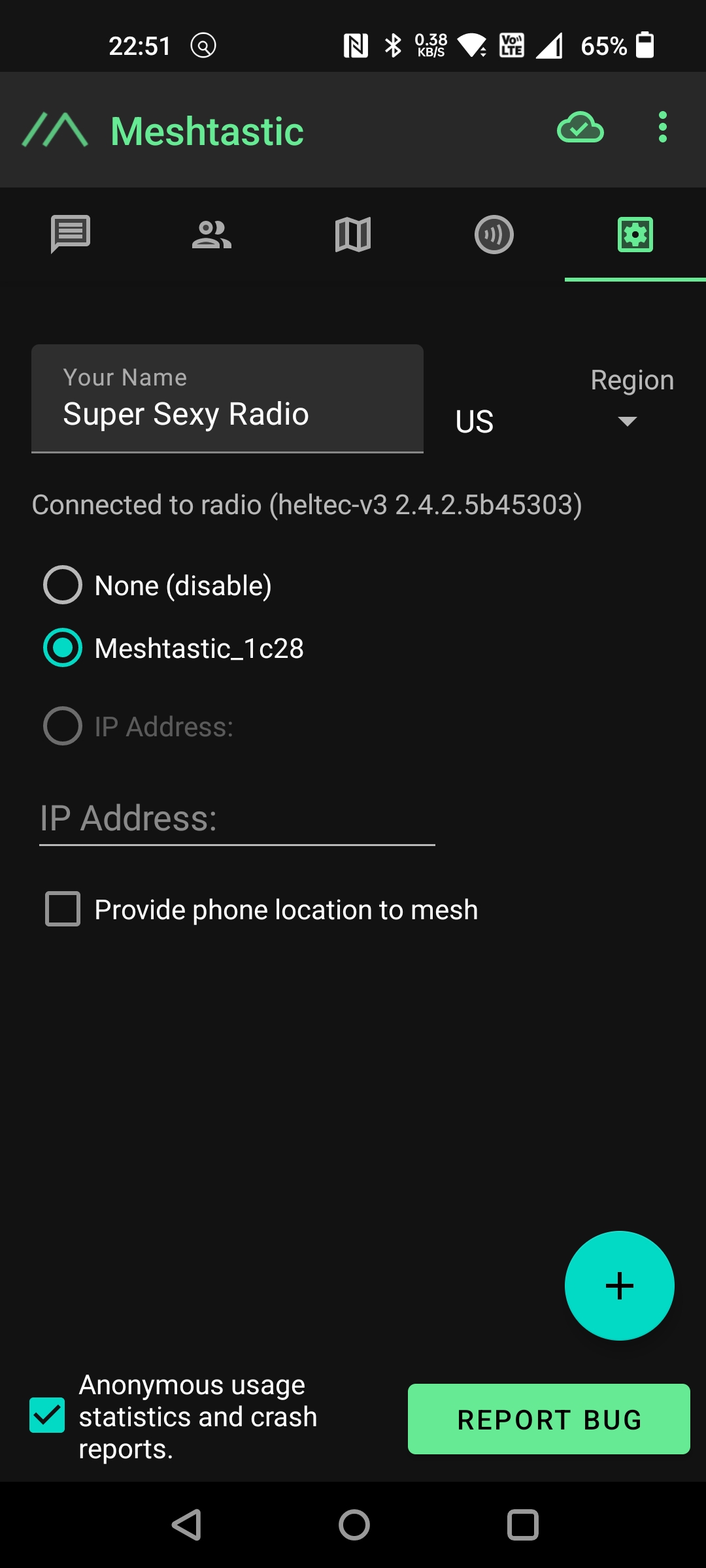

Before you do anything, be sure that the "Provide phone location to mesh" is unchecked. Or you may be letting the entire world know your precise location right off the bat.
Next, change the region to your location. For example, if you are in the United States, set your region to "US". The region controls the frequency your LoRa communicates with. Therefore, it's imperative that you set the correct value.
Now you need to set a name for your radio. Once you are done, the app will send the changes to the radio and cause it to reboot. After the radio has rebooted and the Meshtastic app reconnected, pull down the three dots on the top right and select "Radio configuration".

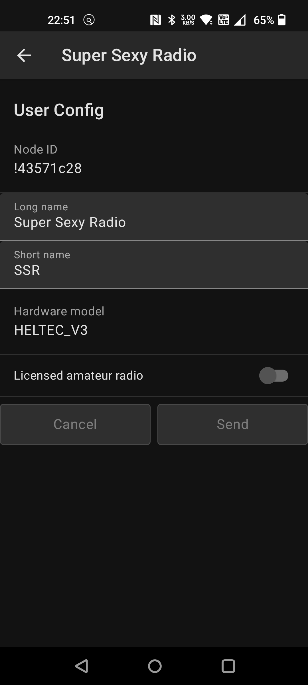

User
In the "User Config" settings, you can change your full radio name. But what's more important is its ability to change the short acronym (Short name), see screen shot below. The app comes up with the short name for you. If you have a desire to change it, do so here and press the "Send" button to send to the radio.
This configuration page also shows your Meshtastic Radio hardware.

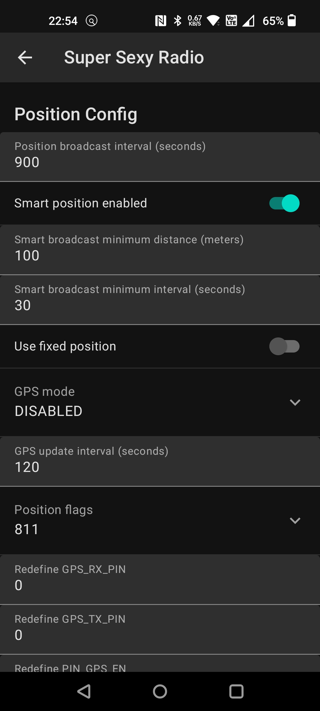

Position
In the "Position Config" settings (see screen shot below), the only thing you need to worry about for now is the "GPS mode" setting. In this article, we are using the Heltec V3 board as the example. And Heltec V3 doesn't have a GPS. The default setting is "NOT_PRESENT" which will check for one constantly, draining battery.
Since we know the Heltec V3 doesn't have a GPS, we will set it to "DISABLED". If your radio has GPS, you are welcome to set it to "ENABLED" only after you are ready to share your location with the world (see "Sharing Your Location" section below).

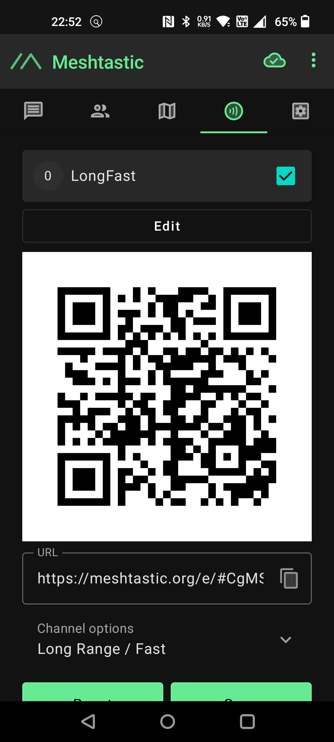

Tap the fourth tab (from the left) on top of the Meshtastic app. You'll see the channel page as shown in the screenshot below. "LongFast" is the default public channel.

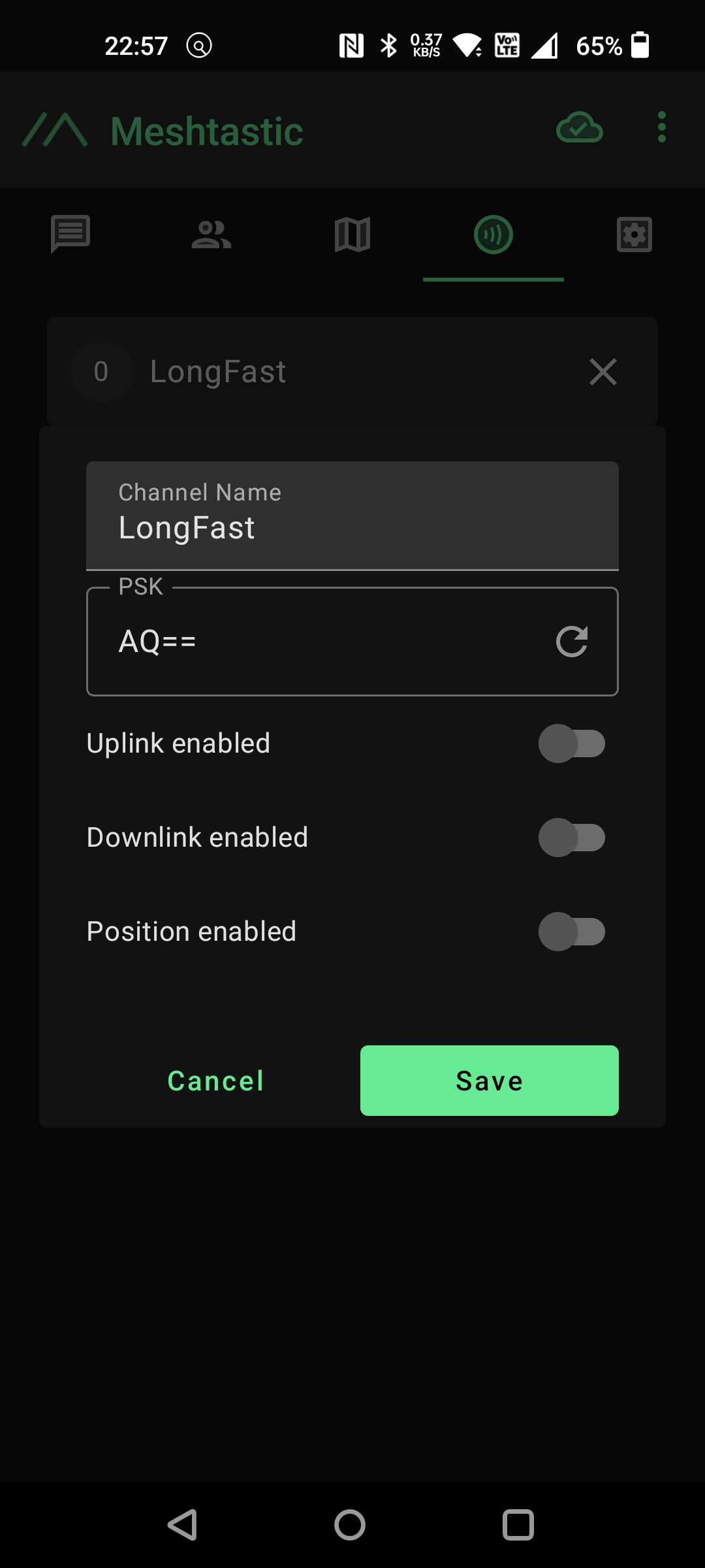

Tap the "Edit" button and then tap the "LongFast" channel to get to the following screen.
Turn on "Uplink enabled" and "Position enabled". If you are comfortable with your "Precise location" being shared, turn that on. Otherwise, turn it off and set your location precision to a value between 148 feet and 14.5 miles.

When you are done with the channel setting, tap the "Save" button. Finally, tap the "Send" button to send the channels setting to your Meshtastic radio. Now your radio is ready to send your location. But it's not doing so yet, until you configure it to use the built-in GPS, your SmartPhone's GPS, or a fixed location. See the next three sections to determine how you would like to provide your location.
