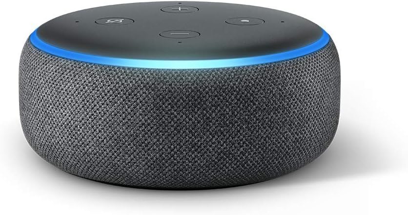

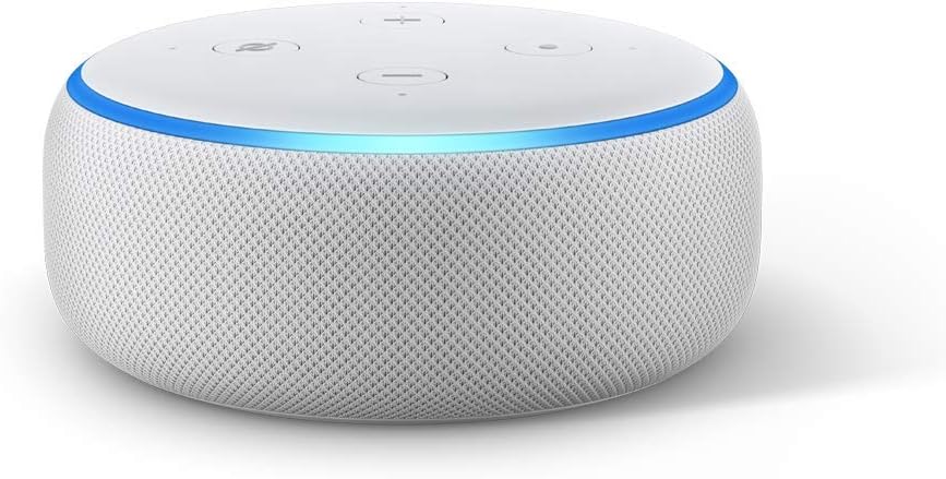

Amazon Echo Dot (3rd Generation) [Alexa]
0.1
1
Idle.
0.03
2
Playing music.

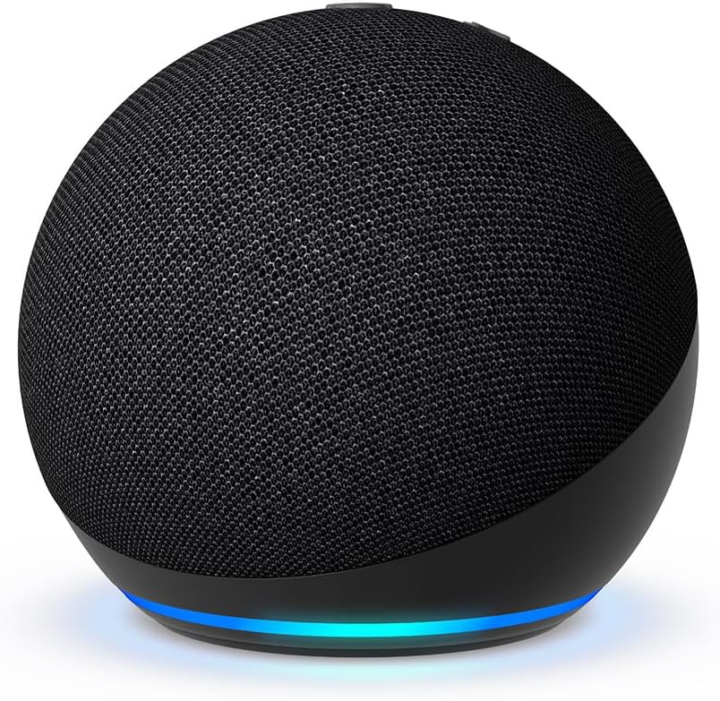

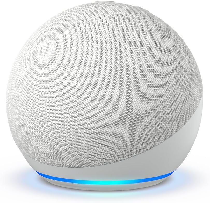

Amazon Echo Dot (4th Generation) [Alexa]
0.1
0
Idle.
0.04
2
Playing music. 50% Volume.

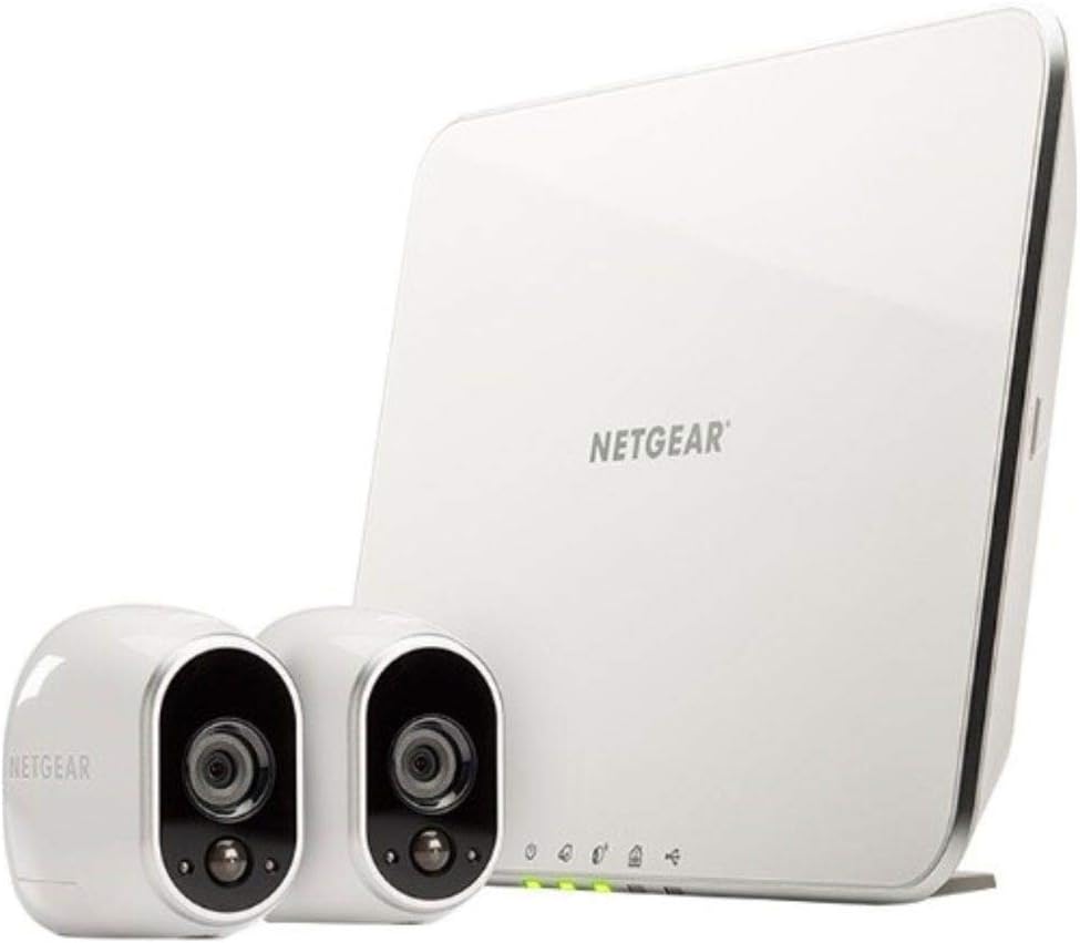

Netgear Arlo VMB3000 Base Station
0.04
3
Five wireless cameras associated. Wired LAN connection.
0.04
3
Five wireless cameras associated. Wired LAN connection. Viewing live video on SmartPhone app.

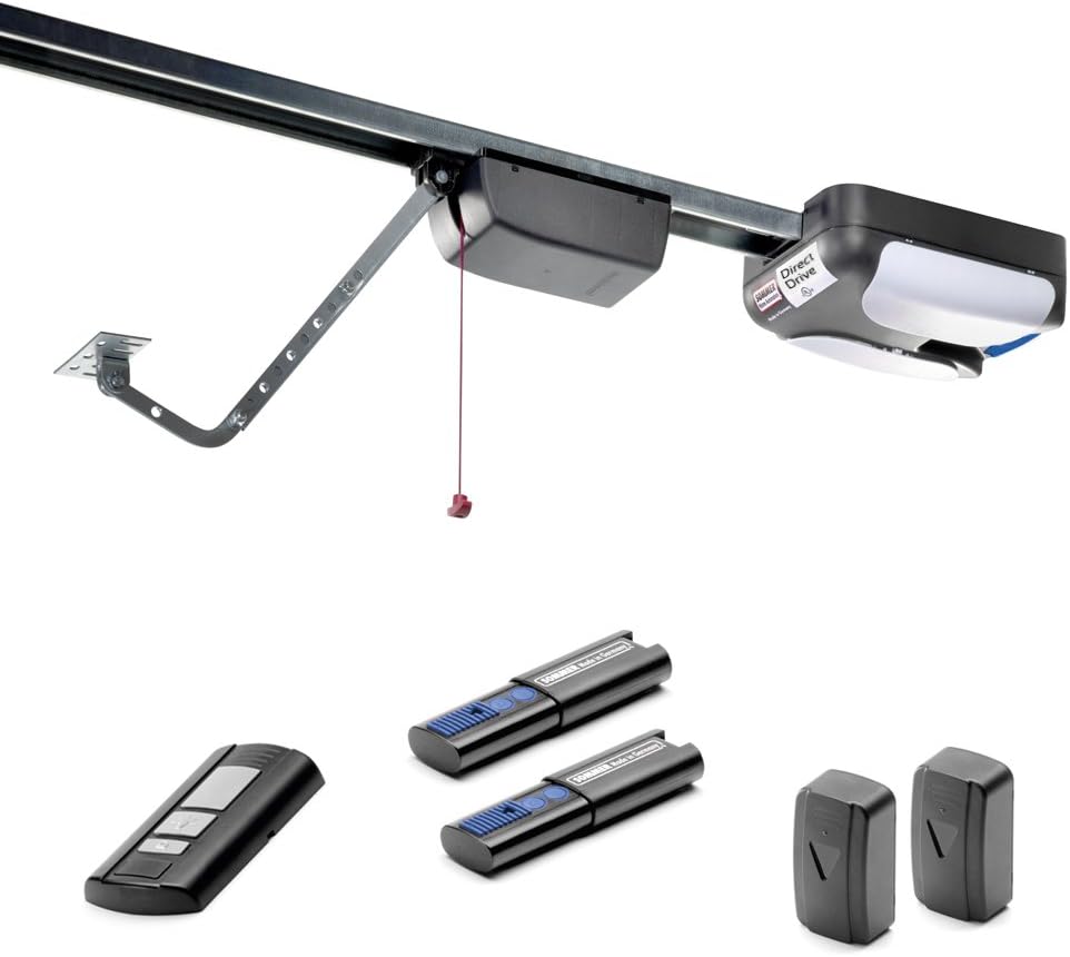

Sommer Direct Drive 1042V001 Garage Door Opener
0.144
5.3
Plugged in. Light off.
