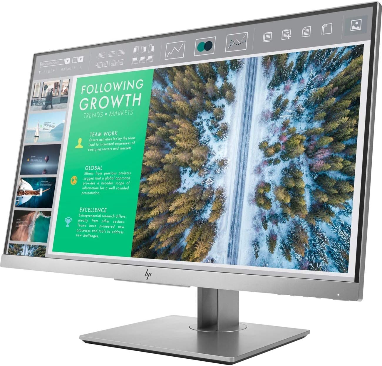

HP EliteDisplay E233 23-inch Monitor
0.166
11.7

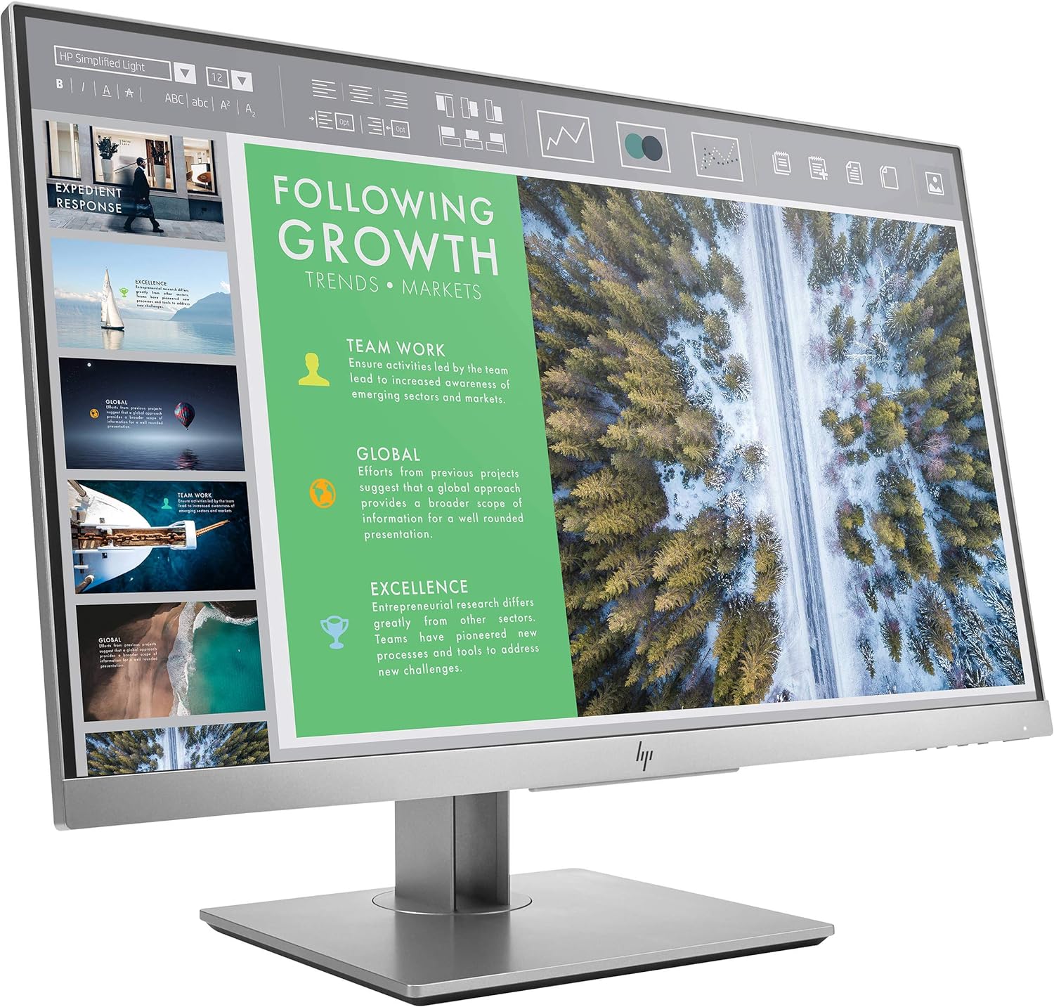

HP EliteDisplay E243 24-inch Monitor
0.222
15.7

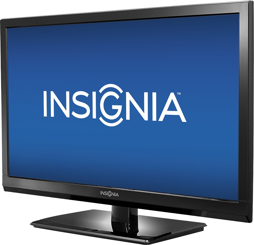

Insignia 24" Class LED 1080p HDTV NS-24E40SNA14
0.355
28

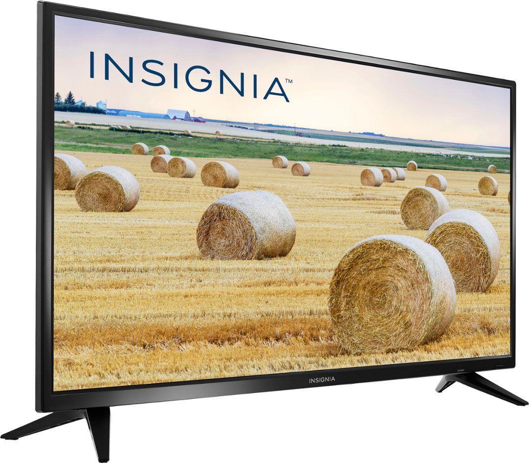

Insignia 32" Class N10 Series LED Full HD TV NS-32D510NA19
0.411
29.8

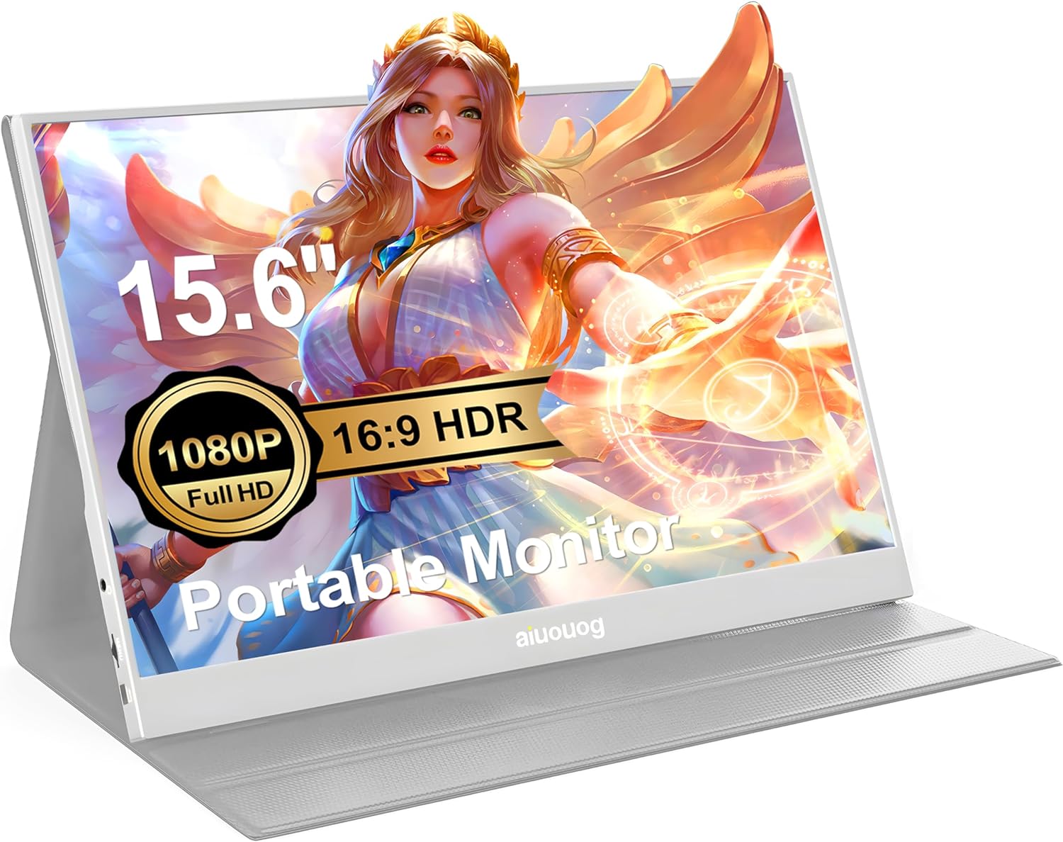

Viewmax 15.6" Portable Monitor F156P1
0.077
5.2
