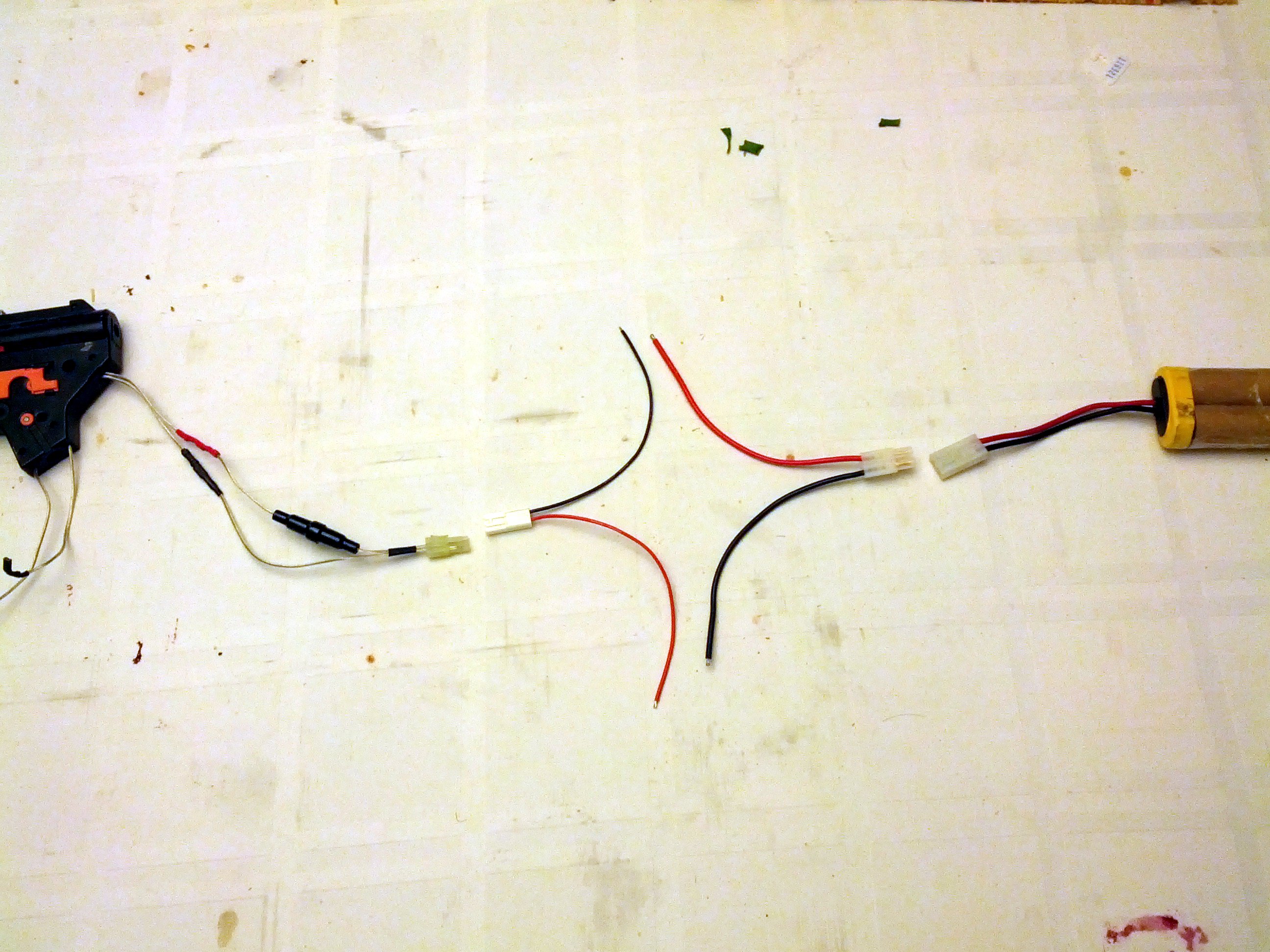

Tamiya Male to Mini Tamiya Female
This adapter is used to connect a battery with a standard size female Tamiya connector to a device (airsoft guns, R/C cars, etc.) with a male Mini Tamiya connector. The photo below shows the sequence of connection from the battery to an metal gearbox of a airsoft gun. Notice that the wires on the connector has to be swapped in order to connect the battery to the device correctly.

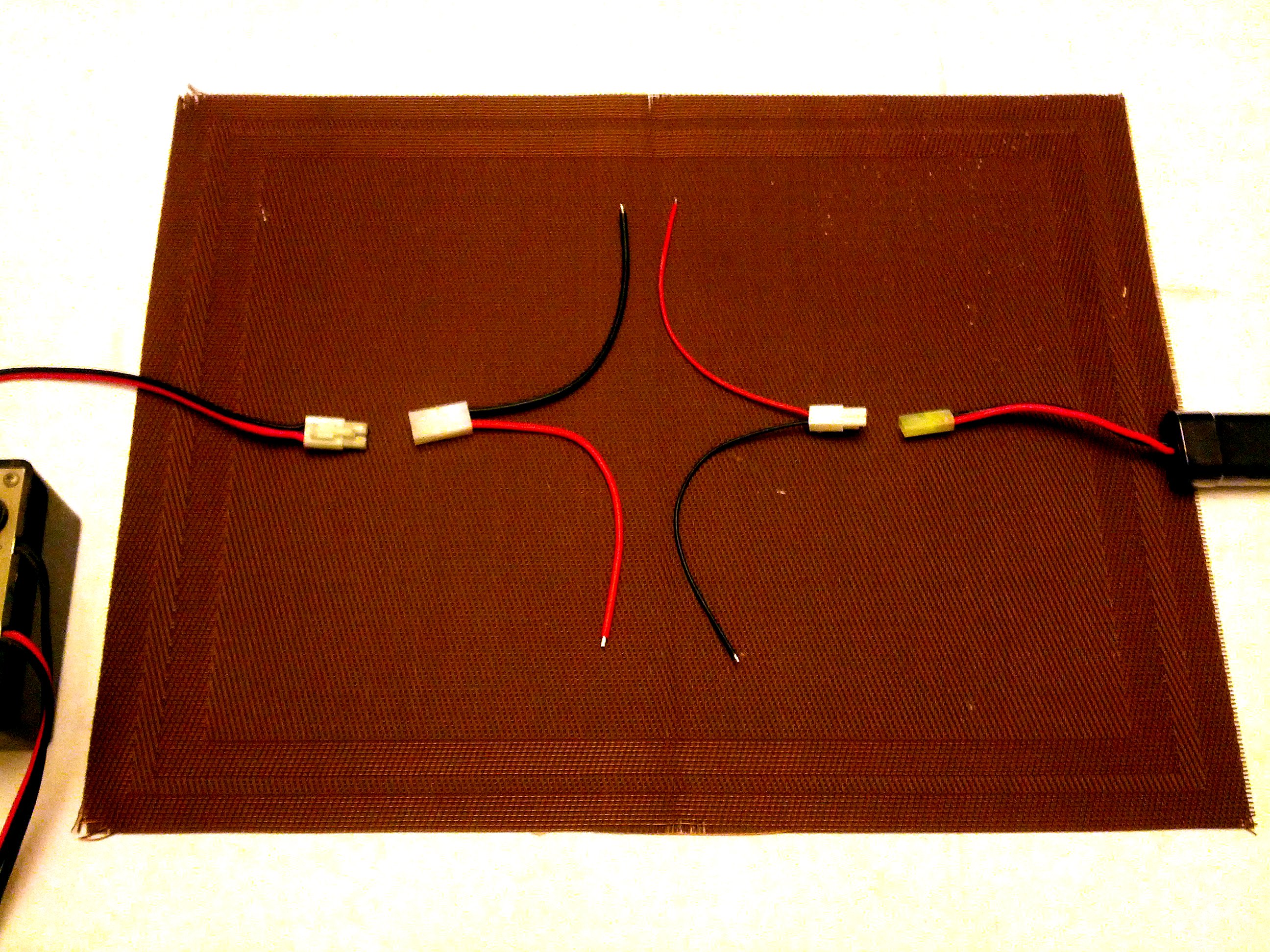

Tamiya Female to Mini Tamiya Male
This adapter is used to connect a battery with a female Mini Tamiya connector to a battery charger with a male Tamiya connector. The photo below shows the sequence of connection from the battery to the charger. Notice that the wires on the connector has to be swapped in order to connect the battery to the charger correctly.

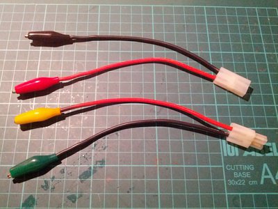

Tamiya to Alligator Clips
Tamiya connectors with alligator clips can be really handy. You can use them to test your hobby with different types of batteries. The alligator clips can clip to various battery holders, etc. It's also great for prototyping your projects.
