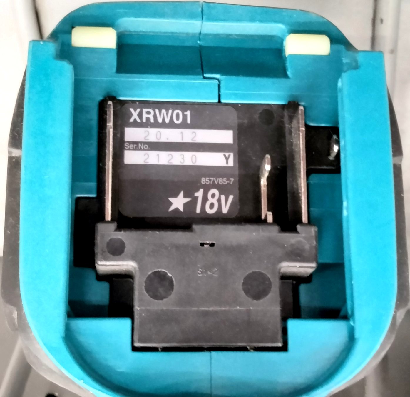

Makita 18V LXT Power Tool Pin-Out
Most of the Makita 18V LXT power tool interfaces to the three major pins on the battery. However, certain Makita products, such as the Makita XRW01 18V LXT Lithium‑Ion Cordless 3/8" / 1/4" Sq. Drive Ratchet interfaces to +, TH, and - terminals on the battery.
That means there is a good chance that the Makita 18V LXT power tool will not operate with the TH terminal covered. So if you want to interface to the Makita 18V LXT power tool with other battery source, you'll have to fake out the TH pin. The question is how?

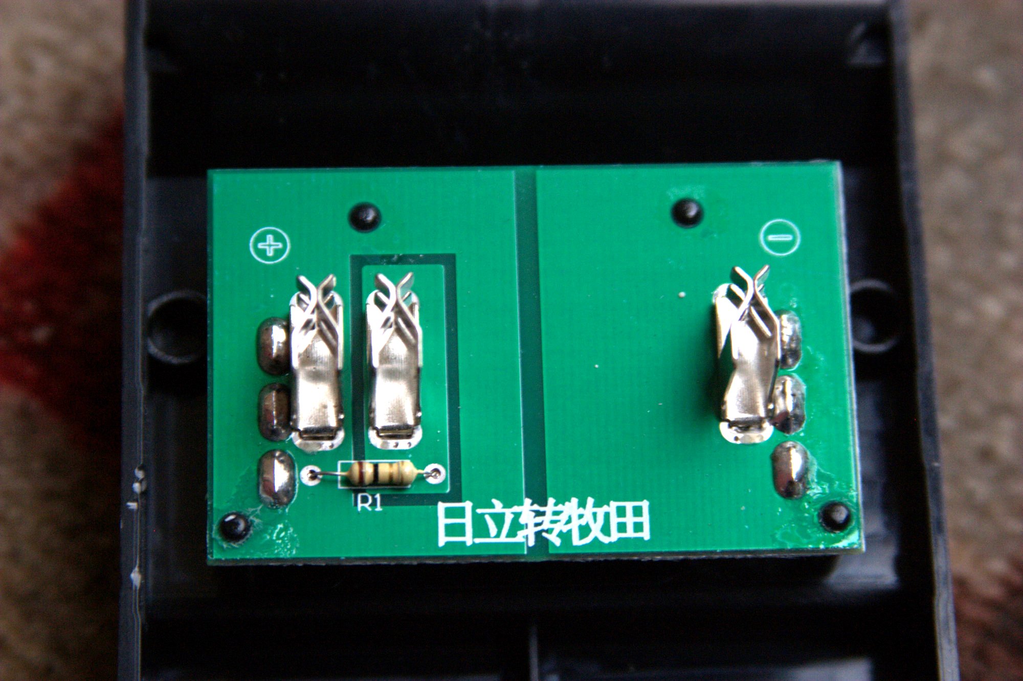

Inside of a Battery Adapter
To answer the question from the previous section, we purchased a battery adapter that converts Hitachi 18V battery to Makita 18V LXT power tool on Amazon. Then we took it apart to see what's inside.
Inside the adapter, there is a very simple circuit board (see photo below). It consists of one simple resistor that ties the + terminal to the TH terminal.
Using the Resistor Color Code Calculator, we determine that the resistor is 1 ohm. Using a digital multimeter, we measured the resistor and found it to be 1.5 ohms.
