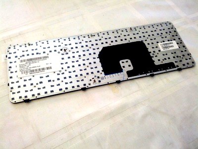

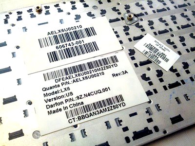

The following photo shows the old keyboard part numbers (in case you are interested). The HP part number is 597635-001. I suspect you'll pay an arm and a leg for it at HP. The Quanta part number is AELX6U00210, while the Darfon part number is 9Z.N4CUQ.001.

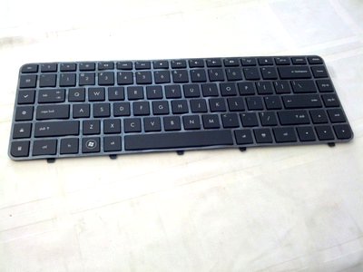

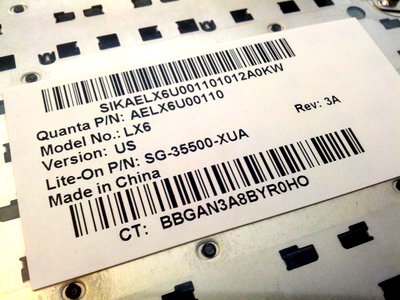

The following photo shows the new keyboard part number (in case you are interested). The Quanta part number is the same. But it has a Lite-On part number of SG-35500-XUA. It's missing the HP part number.

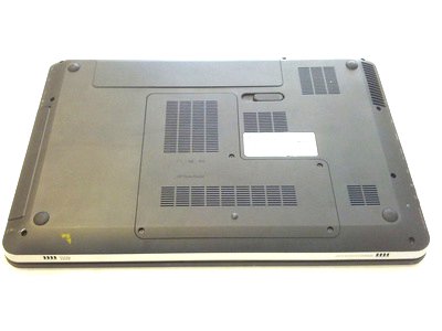

Remove the battery and the component cover (see photo below). Use the Phillips precision screwdriver to loosen the component cover and pop it off.

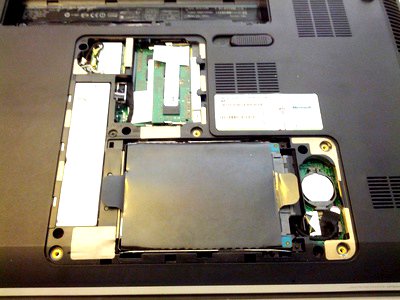

After popping off the component cover, you'll reveal many more screws.
Find all the keyboard screws. They are identified by the keyboard symbol (see photo below). There are five screws. You can use the bottom of the new keyboard to help you locate all five screws.

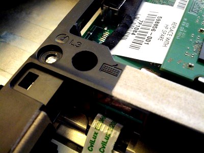

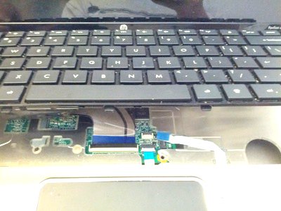

After prying the keyboard up, don't move it too far and tug too hard. It's still attached to the circuit board (see photo below). You don't want to break anything.
Pull up the ribbon cable fastener for the keyboard to loosen its hold on the ribbon cable. Then slide the ribbon cable out and remove the old keyboard. Install the new keyboard and assemble the notebook in reverse.
