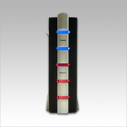

The enclosure has a built-in fan and ventilation. So I am not concerned that the enclosure is made out of plastic. There are five LED's on the front panel. Two blue LED's are for power. Two red LED's are for hard disk access. I have no clue what the fifth red LED is used for.

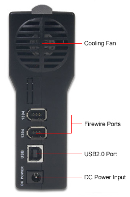

On the back, there is a DC power port, an USB port, and two Firewire ports. The enclosure provides two Firewire ports on the back, apparently you can daisy chain up to three of these enclosures. That will help save precious Firewire and USB ports on your computer.

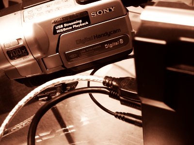

I wonder if you can chain any Firewire device, such as a digital camcorder or a different external Firewire hard drive. So I have tried daisy-chaining with my Sony Handycam (shown in the photo below); it works!

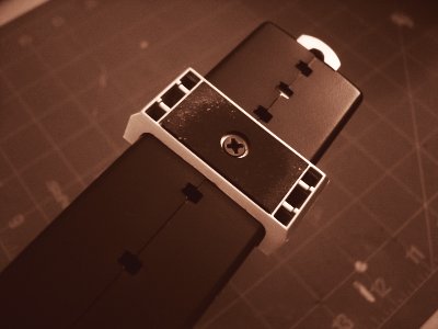

Taking the enclosure apart proves difficult it you don't read instructions first. But it you read the instruction, you will realize that you have to unscrew and take the two feet off first (see photo below). The hardest part is prying the feet off after removing the screws. Once you have done that, you will realize that the enclosure splits apart easily from the bottom.

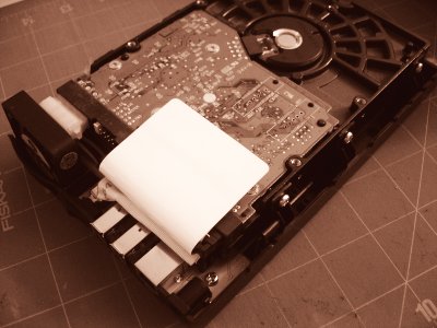

With the enclosure apart, a circuit board with IDE (ATA) interface is revealed. The hard drive power cable and the IDE hard drive cable are real short to keep everything nice and tidy in this small enclosure. The hard drive fits just fine, leaving very little room left in the enclosure (see photo below). The hard drive is screwed into plastic tabs on the enclosure. I haven't crack the tabs myself, but I believe you can easily do that by over-tightening the screws. Putting the enclosure back together is easier than taking it apart.
