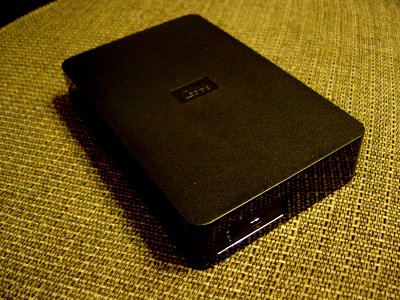

The Western Digital Elements External Hard Drive has a plain black enclosure. It's as if WD made it for people who want to hide their hard drive or keep people from noticing it.

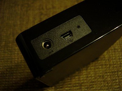

If you look around the case, you'll find no screws or holes of any kind. There is only a power port, an USB port, and a LED can be found on the back-side of the enclosure. WD even put the bright white LED on the back to keep this drive covert.

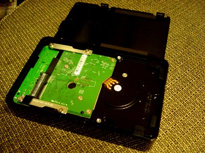

You can find a seam on the bottom of the drive, all around the edge. If you slip a miniature flat-head screwdriver, you can easily pry the enclosure apart (see photo below). The plastic is made to snap together easily, so it's a good candidate for re-use. Unfortunately, the SATA to USB adapter isn't reusable (see below).

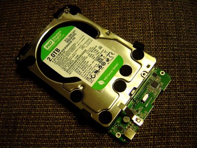

The SATA to USB adapter is mounted to the internal hard drive with two screws. A ground contact is snapped onto the USB port and touches the drive like a clip.

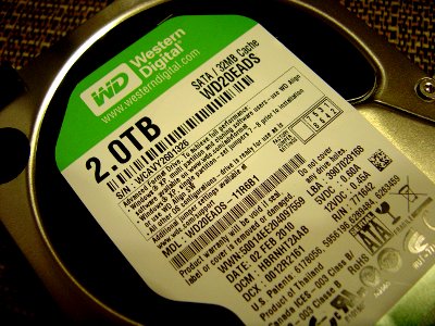

The internal hard drive in the 2TB version is a Western Digital WD20EADS. It is a 3.5" 5400 RPM SATA drive with 32MB of cache.

After pulling the 2TB hard drive out of the Western Digital case, I was able to use it with an USB adapter and within a Seagate USB case. So the internal hard drive is really just a normal hard drive.
