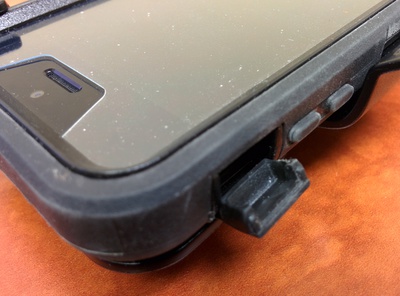

First, take a look at the protective cover in the photo below. When you open the protective cover with your fingernail, there is a chance that the lip on the cover will silence the phone.

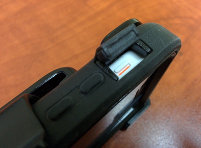

To eliminate the possibility of silencing the phone when you are checking the switch position, the trick is to cut off the rubber lip. A pair of sharp scissors will do the trick easily. See photo below for the cut.
After the cut, there is no chance that the cover will ever make the "switch" again.
