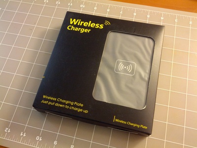

Yes, even the name is generic, as you can see on the box below. And I will be reviewing this Wireless Charging Plate thoroughly in this article.
For a simple generic box, it actually looks quite pleasing. Maybe it's the highly contrasted yellow on the black background. It looks quite elite.

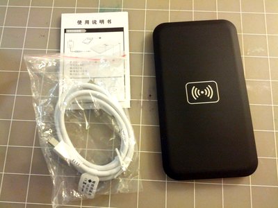

The box content includes the Wireless Charging Plate, a white micro-USB cable, and the instruction sheet (see photo above). Notice that the USB AC adapter is not included. Also, the Wireless Charging Plate I order is black (white version is also available), but a white micro-USB cable is included. That's not a big deal to me, because I have plenty of black micro-USB cables laying around. But if color is important to you, you will want to keep this discrepancy in mind.
The instruction manual isn't very useful at all. There are a number of unspoken "rules" on using this Wireless Charging Plate that isn't mentioned in the instruction manual. Luckily, I will tell you all about in this article, so you can use this article to serve as instruction manual.

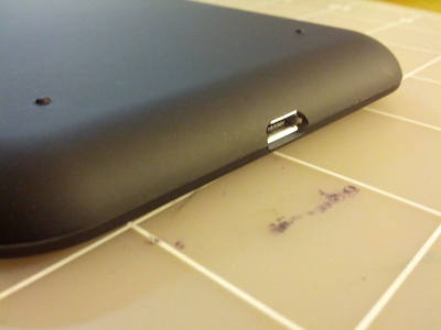

The Wireless Charging Plate has a single micro-USB port for you to supply power via a micro-USB cable (see photo above). Without including a USB AC adapter, the Wireless Charging Plate tempts you to connect it to your computer. But I have found that the current supplied by monitors and computers are generally insufficient to charge the Google LG Nexus 5. Instead, you'll need to use this Wireless Charging Plate with the USB AC adapter that is included with your SmartPhone

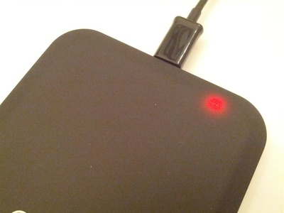

Once you plug the Wireless Charging Plate into a power source, a red LED will glow from within the Wireless Charging Plate (see photo above). I think that's a nice touch. It is very cool, because you can't tell there is a LED there.

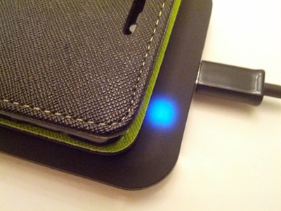

Once you place the Google LG Nexus 5 or other Qi-enabled SmartPhone on the Wireless Charging Plate, the red LED will turn off and the blue LED will turn on (see photo below). The changing in LED color indicates the phone is being charged.

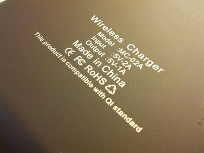

You can see, from the bottom of the Wireless Charging Plate (see photo below), that it actually wants 2 amp input. Unfortunately, the USB AC adapter does not come with the Wireless Charging Plate. In addition, USB AC adapters that serves 2 amps are rare. The only 2 amp USB AC adapter that I have comes from the Google Asus Nexus 7 tablet. See "Related Links" below for good deal on 2 amp USB AC adapters.

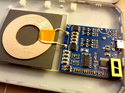

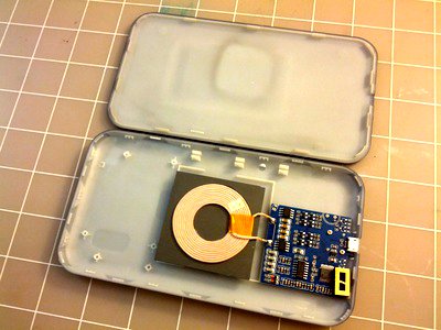

The Wireless Charging Plate plastic enclosure is quite soft and comes apart readily with slight twist. Photo below shows the internal components.
The photo below is a close-up of the circuit board and the charging coil.
