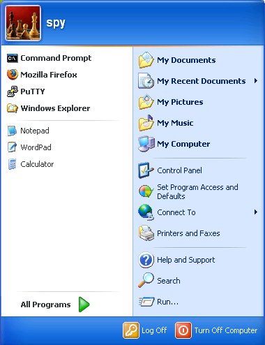

To access System Restore, click on the "Start" button (see screen shot below). Look for the "Help and Support" menu selection. Click on it.

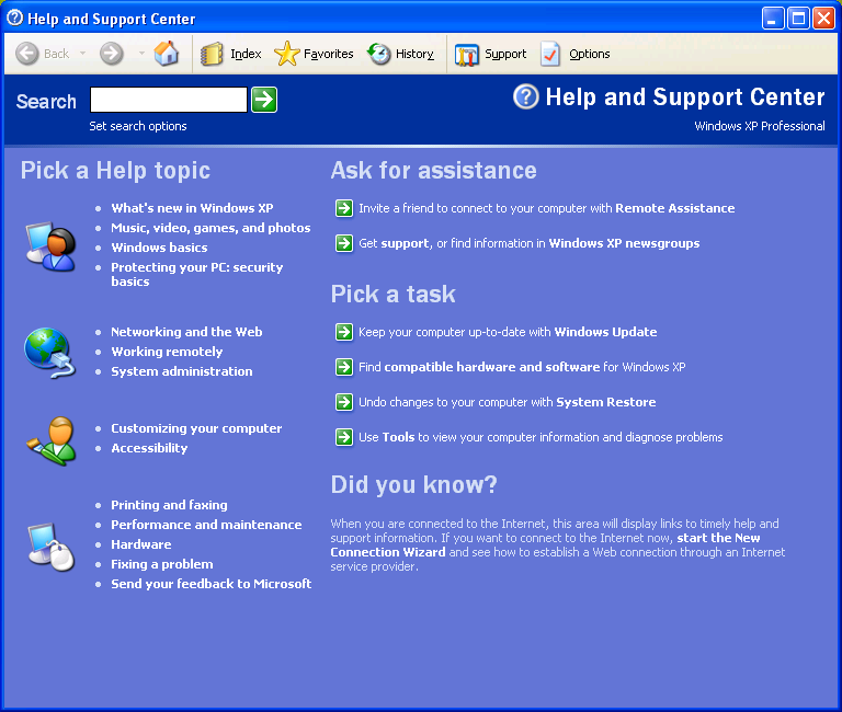

After clicking on the "Help and Support" menu selection, you'll see the following screen. Click on the "System Restore" task.

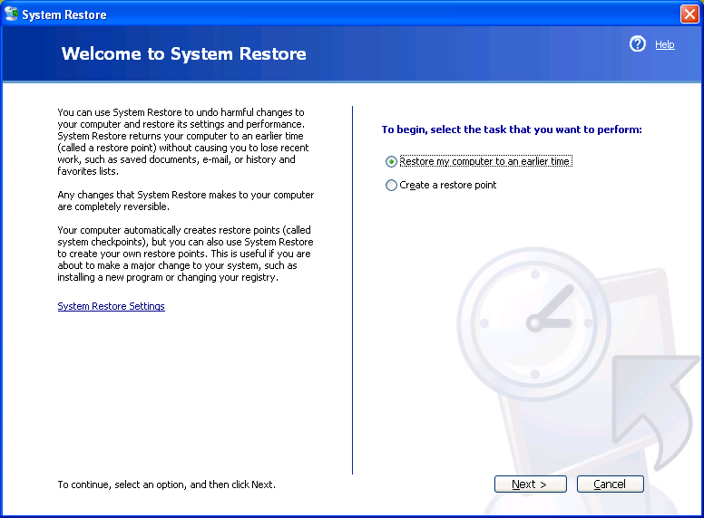

In the "System Restore" application, there are two options to choose from before you can move forward (see screen shot below). Select the "Restore my computer to an earlier time" option. Then click "Next >".

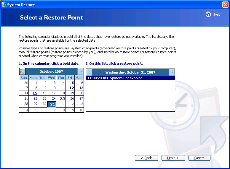

In the "Select a Restore Point" screen (see screen shot below), you pick a date and time before your computer got infected. Use the calendar on the left side to select a date. You can only select a date that is bold. Then pick a restore point on the right. Click the "Next >" button to move on.

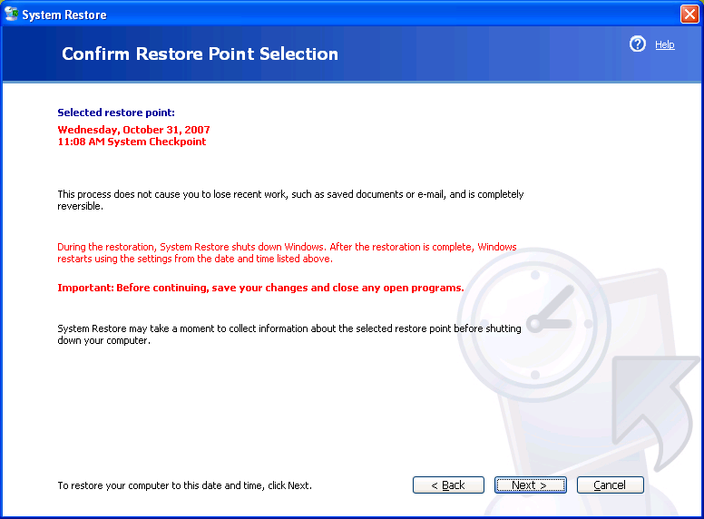

In the "Confirm Restore Point" screen (see screen shot below), you confirm that is the correct restore point you want to restore your computer to. If you are happy with the date and time of the restore point you selected, click the "Next >" button to start the process.
Hopefully when you have restored your system to an eariler time, all of the malice software will be removed and you are done. But if the malice software is persistent, or destroyed your System Restore function, then your best choice is to wipe your system clean by reformatting your hard drive and start over.
