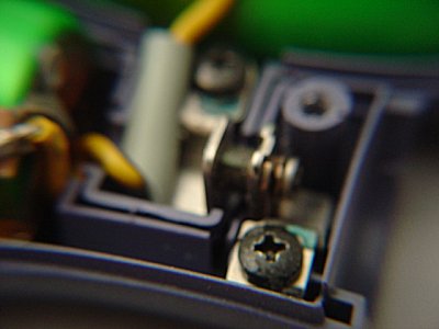

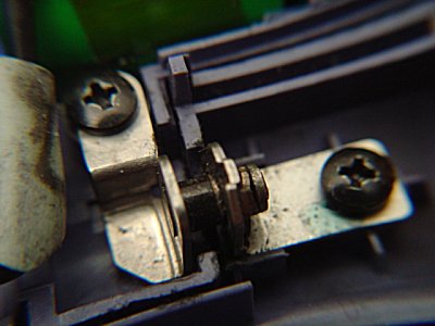

To take the battery pack apart, see the BP52 rebuild article. Once the battery pack has been taken apart, tighten down all the screws and hinge bolts in the pictures shown. The battery pack is engineered extremely well. All of the screw sockets are made out of metal, so nothing is damaged and can be easily repaired.

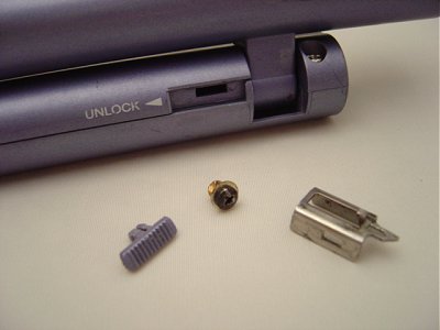

Finally, I would get rid of the lock switch. One primary reason that the hinges loosen is due to the force put onto them when someone tries to swivel the battery pack while it is locked. I have always found the lock switch to be awkward and unnecessary. The swivel operation is a lot smooth after I eliminated the lock switch on my BP52.
