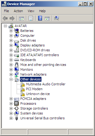

Recently, I installed Microsoft Windows Vista on my Averatec 3120V laptop. Through out the process, I wondered whether Vista will be able to find the driver for all of the hardware in this notebook. Surprisingly, it automatically installed most of the drivers except for the sound card, modem, and an unidentified device (see screen shot below).
Luckily Averatec provides Windows XP driver for this notebook at its support section: Driver Downloads. From that page, select 3120V SERIES, SL3120V-01, then the type of driver you rae looking for. The audio and modem driver both works on Windows Vista.
Unfortunately, I could not figure out what the third unidentified hardware is. So I can't find the right driver for it. If you know what it is, please let me know.
