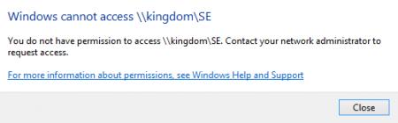

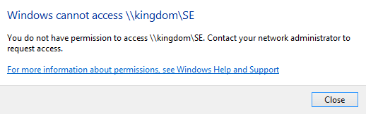

I tried to share a folder today, but got following error message:
"Windows cannot access \kingdom\SE
You do not have permission to access \kingdom\SE. Contact your network administrator to request access."
That's ridiculous, because I shared two other folders in the exact same way on the same server. The two other folders are accessible. These two folders are on the system drive (C:). The one that is not working is drive S:.

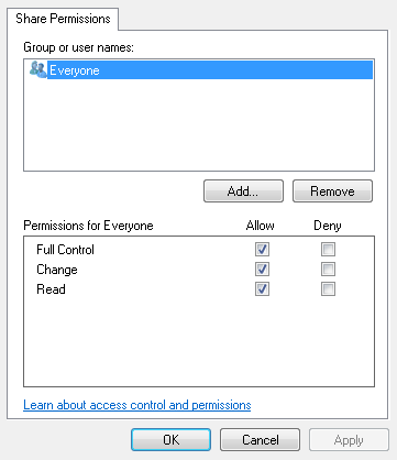

Here is what the permission looks like for everyone:

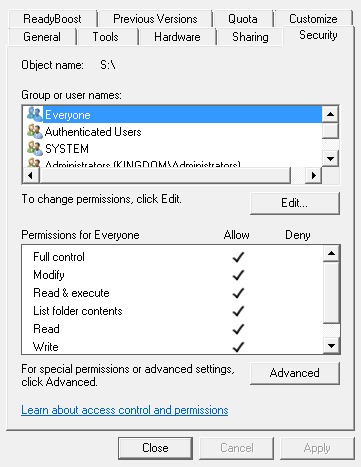

Ok. I finally figured it out. In addition to the "Sharing" tab, there is also a "Security" tab. "Everyone" must be added to the "Security" tab as well (see screen shot below).
