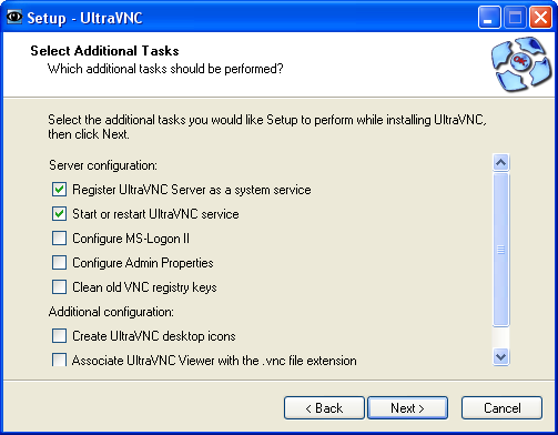

One of the best VNC software on the market is UltraVNC. UltraVNC includes both server and client, so that you can install the same software on both machines. Best of all, UltraVNC is free Open Source software. You can get a copy of UltraVNC from "Related Links" below. When you install UltraVNC as a server, make sure you enable the following two options (show in screen shot below):
  • Register UltraVNC Server as a system service
  • Start or restart UltraVNC service
