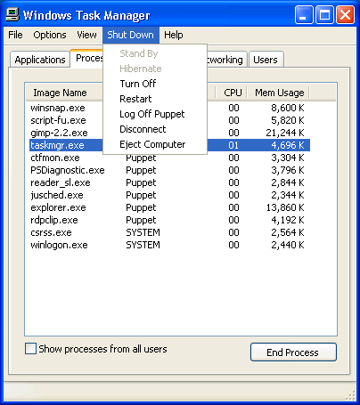

I just found out that you can shut down the computer through the Windows Task Manager (see screen shot below). It works quite fast, compared to the shortcut I made. You can use it to restart the computer as well. My only question is what does "Eject Computer" do? Hopefully, it doesn't send your computer flying out of the window.

Wed, 30 Jan 2008 08:29:36 +0000
The shutdown feature seems to have disappeared from the Task Manager in Vista. But the Shutdown.lnk that I've attached above works beautifully.

Just use CTRL+ALT+END to get to the shutdown menu

Windows 7 no longer has the "Shut Down" pull-down menu on Task Manager. You'll have to use the shutdown command or the CTRL+ALT+END method.
