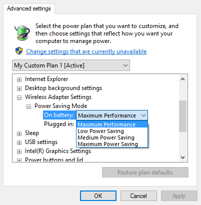

So I dug into the Windows power saving plan, because the only difference is the AC adapter. In the plan, the "Wireless Adapter Settings Power Saving Mode" defaults to "Medium Power Saving" on battery. It defaults to "Maximum Performance" when plugged in. I changed the "On battery" setting to "Maximum Performance" (see screen shot below) and now it's working at both Starbucks locations.
It's looking like their router has some incompatibilities with Windows 10 power saving modes. I tried "Low Power Saving" and it had the same problem symptom as "Medium Power Saving". With "Maximum Power Saving" the laptop computer can't even connect. In fact, I had to reboot the computer after changing the setting to "Maximum Performance" to get the WiFi adapter to work again.

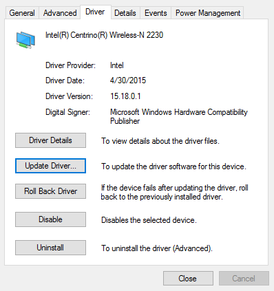

I checked for new driver for it just now. Surprisingly, there was a newer driver as Windows automatically found it, download it, and installed it. The screen shot below shows the driver that was installed. I didn't get a chance to take a screen shot of the older driver. This driver is dated in April. Surprised that it wasn't automatically installed after upgrading to Windows 10.
But I tried the default "Medium Power Saving" mode and it didn't solve the problem. I guess I'm stuck with "Maximum Performance" for now.
