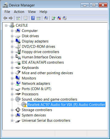

First thing to do is to pull up the "Device Manager" to see what is wrong with your driver. You can do that by clicking on the "Start" menu, follow by right-clicking on "Computer", choose "Properties", and finally click on "Device Manager" under "Tasks".
The screen shot below shows an example of the "Device Manager". It is indicating something is wrong with the "Realtek AC'97 Audio for VIA (R) Audio Controller" by displaying an exclamation mark.

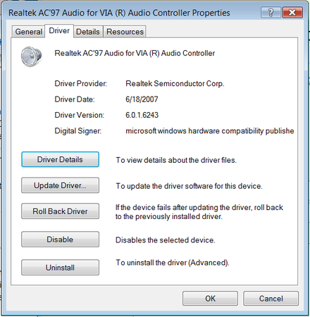

To fix the problem, right-click on the non-working driver, then choose "Properties". You'll see something like the dialog box in the following screen shot. As you can see Windows Vista reports that "This device cannot start (Code 10)".

Click the "Driver" tab. Once you do, you'll see the following screen.

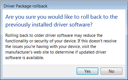

Click on the "Roll Back Driver" button. Windows Vista will ask you to confirm with the following dialog box.
Wed, 27 Feb 2008 06:26:03 +0000

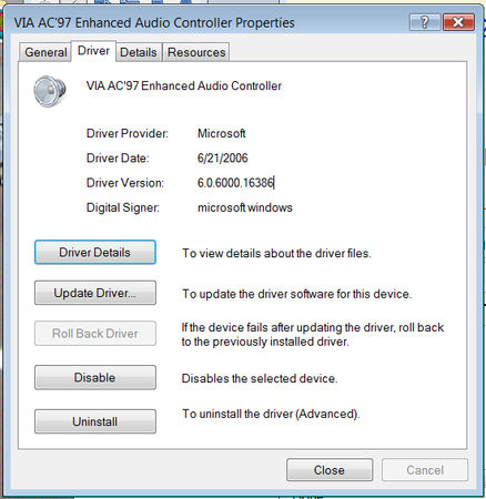

Click on the "Yes" button. Windows Vista will proceed to uninstall the latest driver and reinstall the previous working driver. After it done its job, you will see the following dialog box, where it shows you the details of the previous driver.
Apparently, the previous working driver is the "VIA AC'97 Enhanced Audio Controller" that is dated 6/21/2006. After rolling back to this driver, the audio is once again working on my Entertainment PC.
