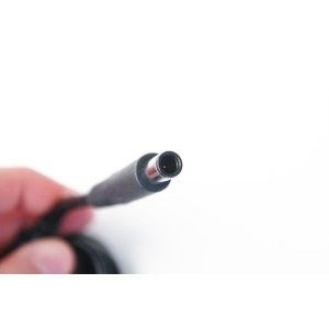

After getting the Asus G46VW-BSI5N06 gaming ultrabook, it's time for me to purchase extra power supplies for convenience--one in the bag, one for my desk, and one in my office. But the Asus G46VW is so new that parts for this laptop is not available anywhere yet. It's got a really hefty power supply, so I can't just use any universal power supply as a replacement. It's specs are:
Input: 100-240V 50-60Hz 2.5A
Output: 19.5V 9.23A with positive tip.
Searching for it's "FA180PM111" model number yield numerous results. In fact, I found that the same 180 watt power supply is used by the Dell and Alienware laptops. The only problem, it seems that the tip to plug into the laptop is different. Based on image from the following Amazon product page, the Dell version's tip has a center pin (see attached photo).
Genuine Dell 180W Watt 74X5J, JVF3V Power Adapter PA Charger For Laptops
The Asus version, on the other hand, has no center pin. The other minor variation is that the Asus version has an angled tip, versus a straight tip on the Dell version.
My guess is that the Dell version will work on the Asus and vise-versa, but only if you take the time to cut and solder a new tip onto it.
