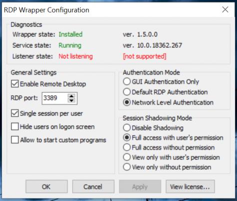

Just installed the RDPWrap 1.6.2 on my Windows 10 tablet. But when I launched RDP Wrapper Configuration, it shows that the "Listener state" is "Not listening". And it shows "[not supported]" next to it. Why does it do that? I am attaching a screen shot.
