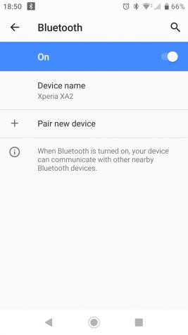

Step 1: Turn On Bluetooth on Android SmartPhone
My Sony Xperia XA2 is running Android 9 operating system. So your SmartPhone could be slightly different in turning on the Bluetooth. But the concept and sequence are similar.
  1. Launch the Android "Settings" app.
  2. Tap on "Device connection".
  3. Tap on "Connection preferences".
  4. Tap on "Bluetooth".
  5. Enable the "On" setting. (See Screen Shot below).
  6. Note the "Device name". You will need it to pair it with your computer.
There is also an easier way to turn Bluetooth on and off. Simply pull down the menu bar and toggle the Bluetooth setting to on. I provided the comprehensive steps above just to be thorough.

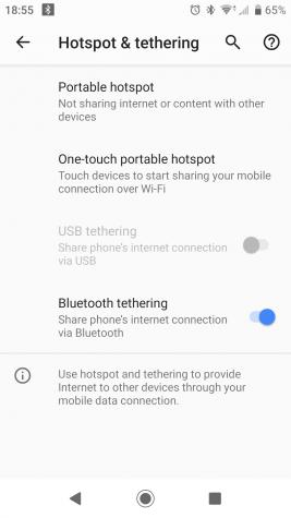

Step 2: Enable Bluetooth Tethering on Android SmartPhone
Just like the last step, the instructions I provide here is based on Android 9 operating system. Your SmartPhone may be slightly different.
  2. Tap on "Network & internet".
  3. Tap on "Hotspot & tethering".
  4. Enable "Bluetooth tethering". (See screen shot below).

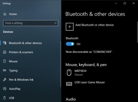

Step 3: Pair Your Computer with Your SmartPhone
This step assumes that your computer and your SmartPhone aren't paired with each other yet. If you have already paired them, you can skip this step. This stem also assumes that your computer has Bluetooth capability. Many laptop nowadays has Bluetooth built-in. But if you computer doesn't have Bluetooth capability, you can get a Bluetooth USB dongle for your computer. I'll add some Bluetooth USB dongle links at the bottom of this article if you would like to get one.
  1. Go to your icons on your Windows 10 task bar and find the Bluetooth icon.
  2. Right click on the Bluetooth icon to pull up its menu.
  3. Click on "Add a Bluetooth Device" from the menu.
  4. Click "Add Bluetooth or other device". (See screen shot below.)
  5. Click "Bluetooth".
  6. From the list of Bluetooth devices, select your SmartPhone based on the "Device name" that you saw earlier.
  7. When the computer and the SmartPhone attempts to pair with each other, click on "Connect" on the computer and tap on "Pair" on the SmartPhone. The two devices will connect to each other.

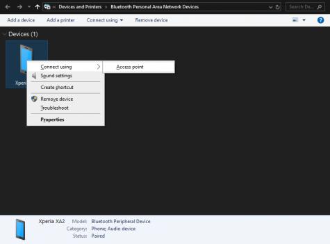

Step 4: Connect to Internet via Bluetooth on Windows 10
After the two device has paired and connected, it's time to activate the Internet access via Bluetooth on Windows 10.
  3. Click on "Join a Personal Area Network" from the menu.
  4. Right click on your SmartPhone device to pull up its menu.
  5. Click on "Connect using" menu item.
  6. Click on "Access point". (See screen shot below.) Note that if you do not see "Access point" as a menu choice, but rather, you see "Direct connection", then your computer isn't paired to your SmartPhone in the right manner. Unpair the two devices with each other and re-pair them by following step 3 above.
Once the connection is successful, your computer will be access the Internet through the Bluetooth connection to the SmartPhone. And depending on how your SmartPhone is getting its Internet, your computer will be accessing the Internet from the same source.
Albert
Sun, 05 Jan 2020 19:24:59 -0800
After you perform the last step, you'll be able to enjoy Internet on your computer just like on a Wi-Fi network. I much prefer this Bluetooth tethering method over the WiFi portable hotspot method, because whenever you enable the portable hotspot, the SmartPhone turns off its Wi-Fi and you are forced to use your cellphone network. With this Bluetooth tethering method, your SmartPhone could be connected to a fast WiFi network and serving it through the Bluetooth tethering connection.
