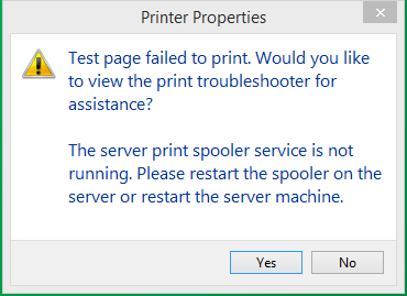

We have a Laser Printer that is shared via a Windows server. However, one of our Windows 8.1 client couldn't print yesterday. When we tried printing a test page, we get the following error:
Test page failed to print. Would you like to view the print troubleshooter for assistance?
The server print spooler service is not running. Please restart the spooler on the server or restart the server machine.
Interesting. We never had problem with the print server before.

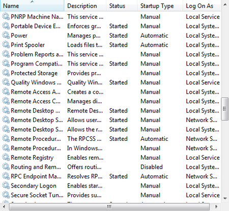

So we used Remote Desktop to access the Windows server. Using Administration tool under Control Panel, we loaded up the Services tool. The Print Spooler service seemed to be running fine as shown in the screen shot below. Just for giggles, we stopped and started the Print Spooler server. However, the problem persisted.
Our Windows 8.1 client still can't print. And it still report the Print Spooler being off-line.
