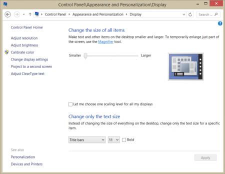

I found a way to keep Windows from up sampling all windows:
  1. Right click on the desktop.
  2. Select "Screen resolution" from the pop-up menu.
  3. Click on "Make text and other items larger or smaller".
  4. Under "Change the size of all items", move the slider to "Smaller" (see screen shot below).
There! Now you can use your high resolution display as intended to be used by a guru... perhaps, with squinting eyes.
