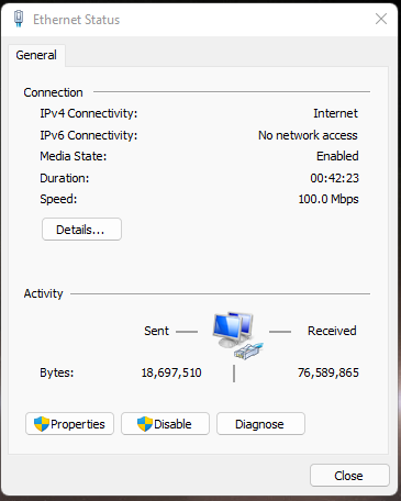

Just got a brand new Asus TUF Dash F15 (TUF516PE-AB73) gaming laptop. But when it boots up Windows 11, I noticed that the wired ethernet connects at 100 Mbps (see screen shot below).
If I disable and enable the adapter in Control Panel -> Network and Internet -> Network Connections, it will, often times, switch itself to 1 Gbps. Disconnecting and reconnecting the ethernet cable itself from the switch will also do the same.
The device driver reports that it is a "Realtek Gaming GbE Family Controller". I did test the transfer speed by moving a large file (1 GB or larger) over LAN. And it is about 5x faster when connected at 1 Gbps over 100 Mbps.
Why is the computing booting up at 100 Mbps? Why doesn't the computer boot with 1 Gbps connetion?

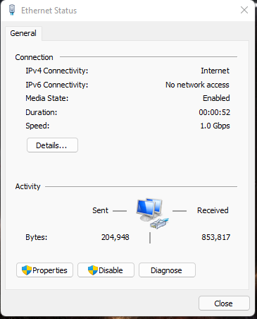

I just did the disabling/enabling and as you can see in the screen shot below that it is now connected at 1 Gbps.
