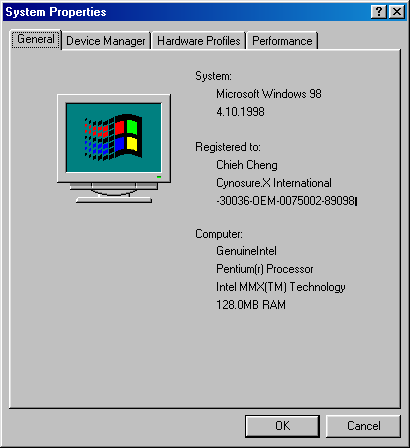

Ummmmm . . . as far as I can tell, my Sony VAIO notebook is still running Windows 98. The General System Properties dialog box shows that it is running Microsoft Windows 98 4.10.1998. So why is the driver installation program not working? Sometime I really wonder how companies write their driver installation software. How do they detect which operating system it's running on? It's no wonder end users have so much problems with new gadgets.
I really wish companies would stop writing operating system checks on driver installation. It seems to create more headaches for users than solving problems. And it limits potential software use (see my "How to get the FujiFilm Advantix Image-Scanner AS-1 Filmscan-it to work with Windows XP" article).

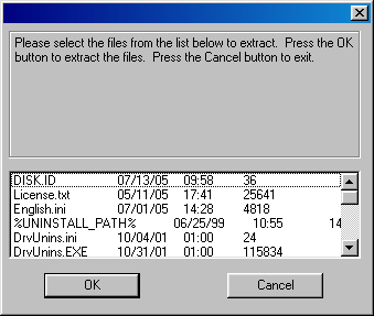

After running the driver installation executable, I found that it is using the WISE installation routine. So I searched for "wise installation extract", hoping I can extract the driver myself for installation. The search got me to a web page called "Mark's 14 protector's commandments", where I found that WISE installation executable accepts several command-line arguments:
  • /T Test Mode. The installation runs but no changes are made to your system. Useful for playing around.
  • /M Manual Mode. This option gives you total control of the installation.
  • /X Extract Mode. Allows you to select individual files to extract. Very useful. Sometimes there is a full version right there with the demo version!
Using the extract mode, I found the following attached screen. Wow! Now I'm getting somewhere.

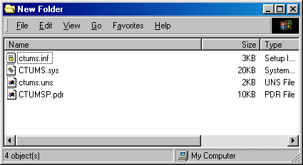

Success! It turned out that the four files that need to be extracted are ctums.inf, CTUMS.sys, ctums.uns, and CTUMSP.pdr. With these four files in a directory and Windows hardware installation wizard pointed to that directory, the driver will install just fine.
Now, that's a lot of work for just installing a single driver for a MP3 player on Windows 98. And I have an advantage at doing this kind of work because I'm a computer scientist. It'll be hard for a typical consumer to install a driver like I did. Consumer electronics companies gotta get their act together at creating better driver installation software than the Creative MuVo2 has provided.
